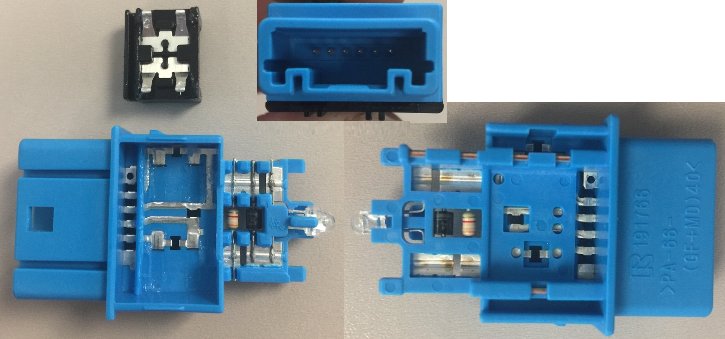

    With a 9 volt battery verify LED. If no illumination invert positive and negative. 2 & 7

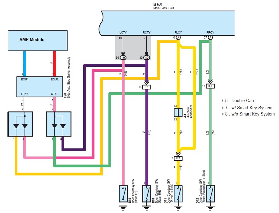

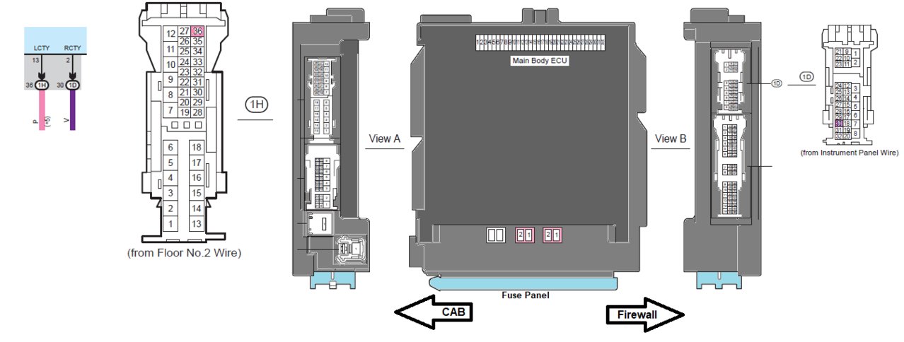

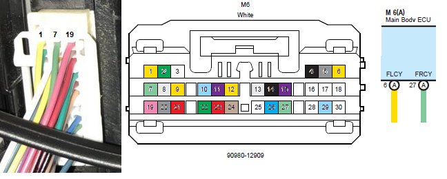

    Duplicate the 4Runner:
    With this:
    36_1H & 30_1D Driver's Junction Box (& fuse)
    M6_6 & 27 Main Body ECU connector
    @daveeasa could set you with the diodes. Or
    Sumitomo 3 Pin M Double Diode
    Sumitomo part number 6098-0129
    Part name 3P-CA 090D 3M1.5 C
    Sumitomo 3 Pin Female Connector
    Sumitomo part number 6247-5031
    Part name 090 3PF
    http://www.cycleterminal.com/mt-built-in-diode.html

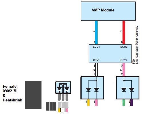

    Still can't buy the darn cycleterminal female housing, I check all the time.
    I do have some 2 position 280-style diodes which I paid way too much for, could throw them in a metripack 6 pin w the cap or maybe try to get one of the square-ish 4 position guys? No need for an extra fuse to make the 6 the best option? I haven't yet purchased the mounting tabs for them, they are in my waytek cart waiting for me to shell out the $...

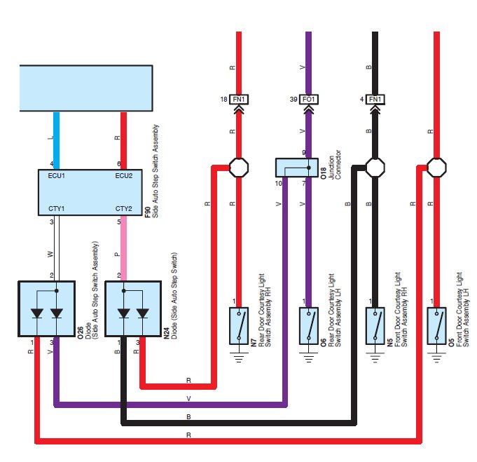

    Thanks so much guys! The diodes are needed due to combining the front and rear door signals, correct? If so, I'd only need one of them for the passenger side. For the driver side, I only have the front door set to trigger the steps. The rear door is used mostly for loading stuff into the truck and it's easier on the shins if the step doesn't extend. :)

    Heat shrink could work. A little proletariat though, don’t you think?
    These are the diodes I do have, not as clean as the 3 position option.

    It's a hidden item once installed, no need to use epoxy filled heat shrink. It's quick and tight. One small diameter ones on each female terminal and a large type for the whole "assembly".
