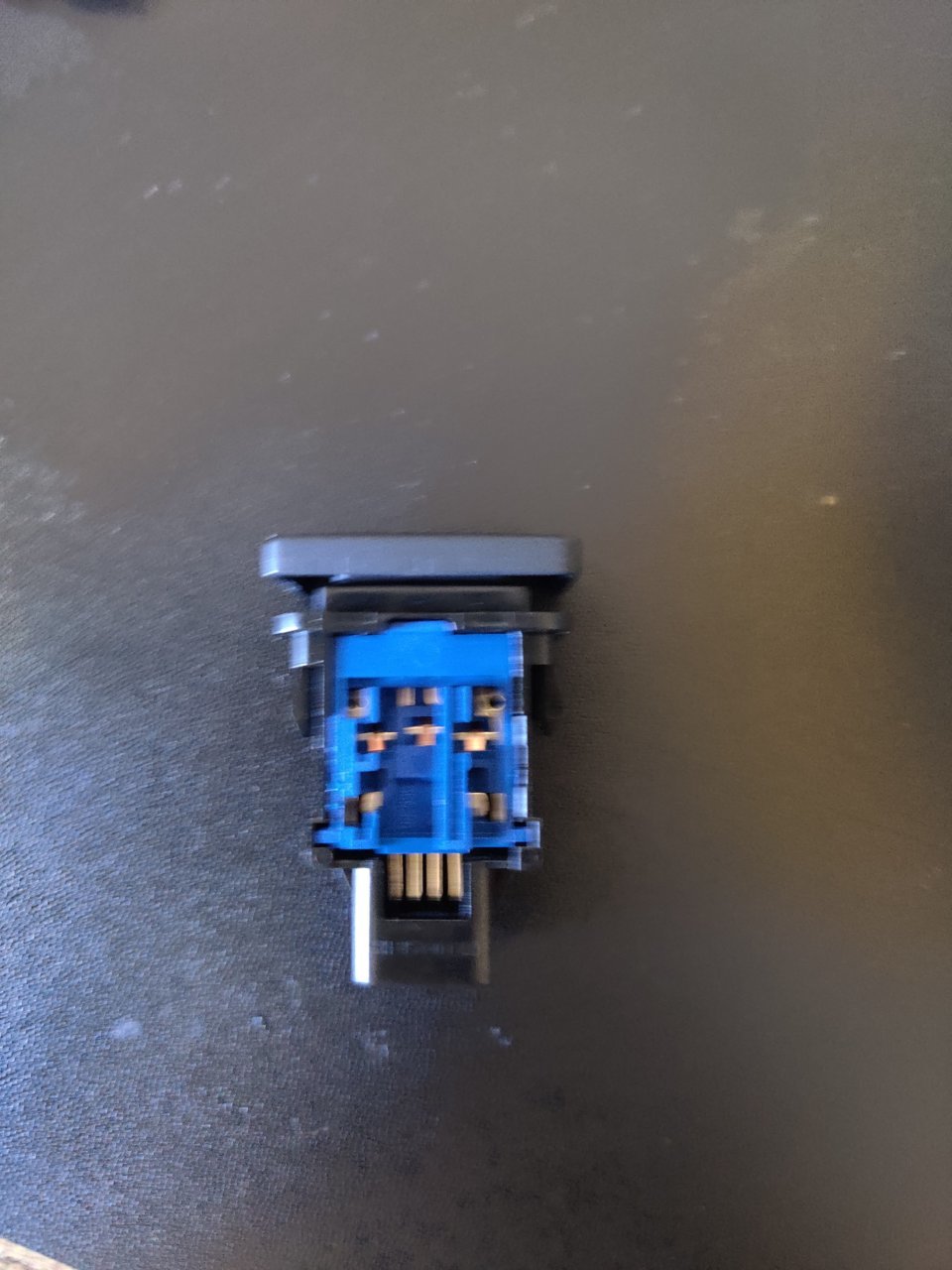

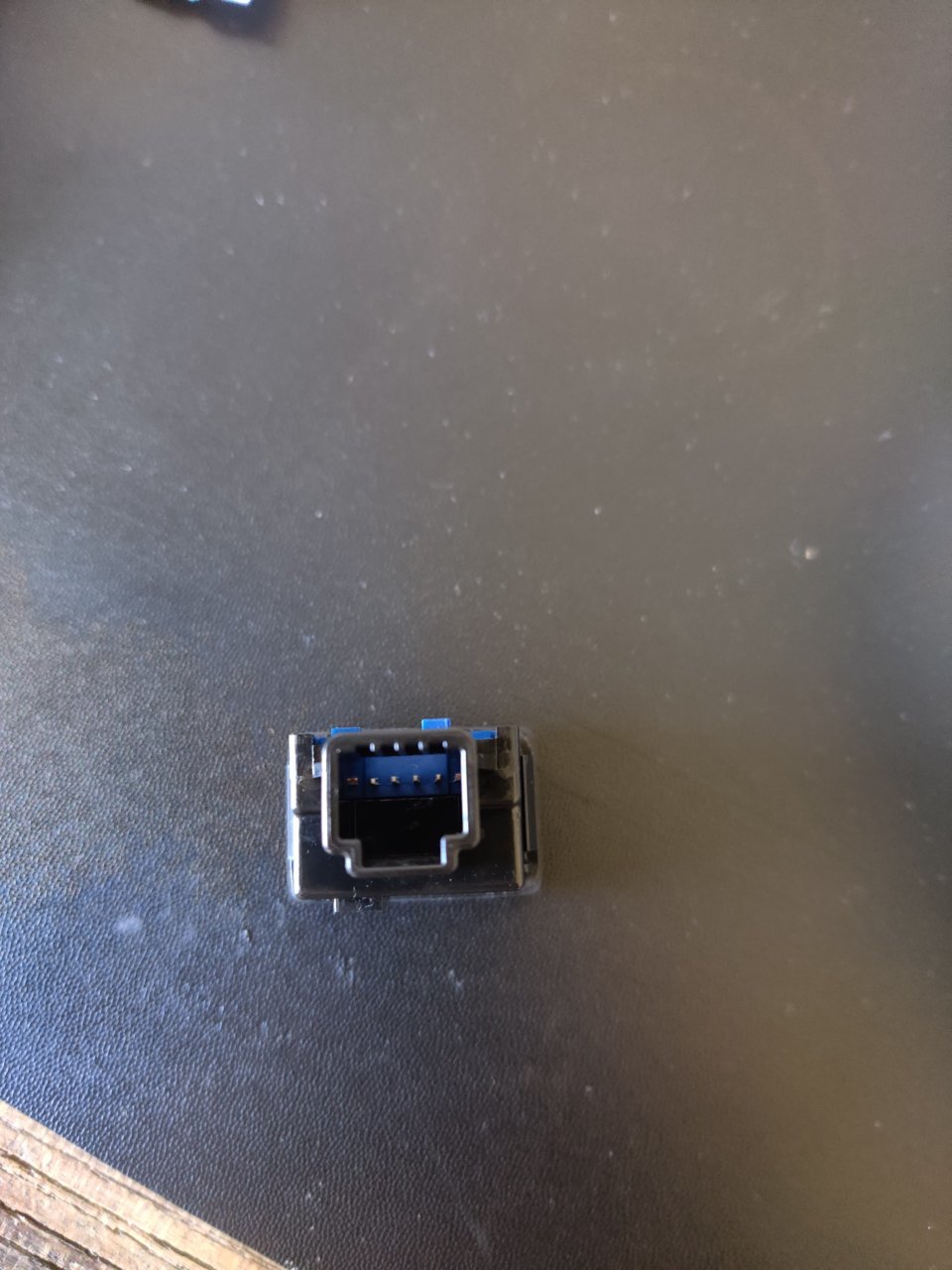

    Sorry, let me be more specific.
    Where can I get a male connector for this switch. (See pictures attached)

    This comes up a lot. You actually want the female. Female connectors for switches often snap inside the male connector even though that is counter-intuitive. The gender is derived from the pin (male) or socket (female) terminals. In your photo, the switch has pins and is therefore male.

    90980-12551 it takes TS 025

    That's good to know, thank you for clarifying this. So I should be looking for a a female connector or a male housing?

    The housing gender is determined by the terminals, so if you want one that plugs into that, they are both considered female. It takes some getting used to. The you get some manufacturers that make “reverse” plugs, and that rule goes out the window.

    See Johnny's links above, hi-1000 typically comes with terminals (and seals if needed) which makes life easier.

    You guys are awesome! Thank you all.
    Parts ordered.
