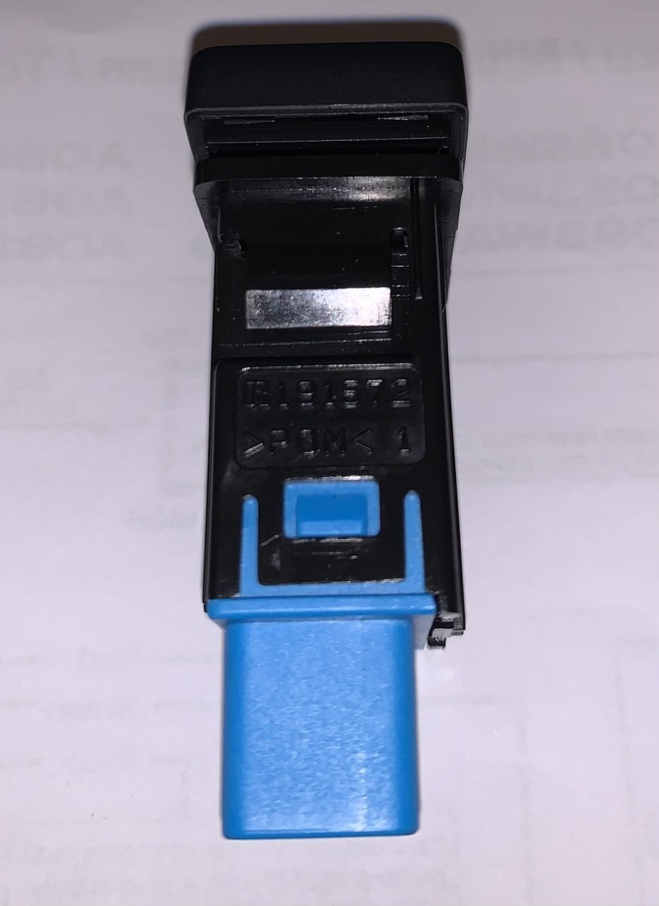

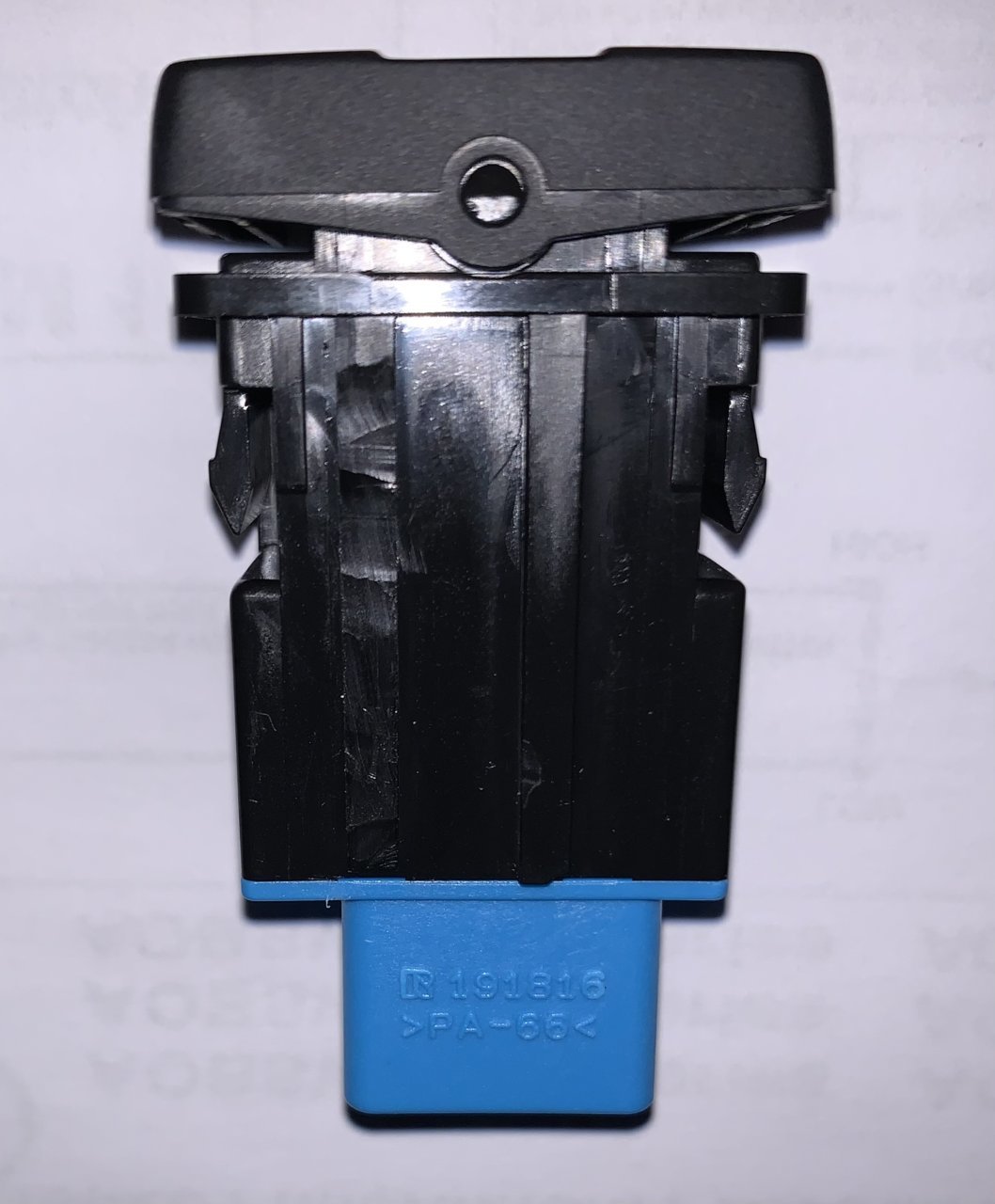

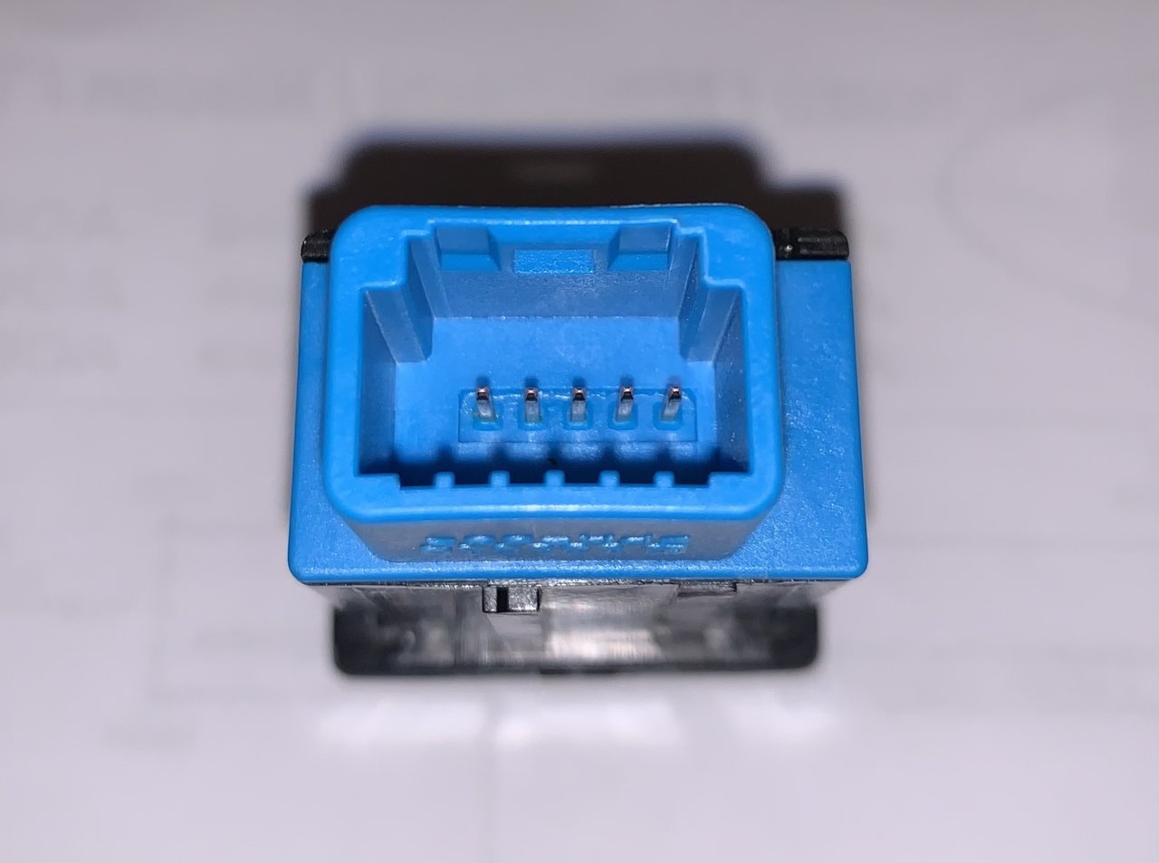

    Hey guys,
    I am looking for the connector that will fit this OEM switch. Only need the piece that houses the female pins that plugs into the switch and I already have the pins. The part number for the switch is 84873-60020. The numbers printed on the switch connector housing are:
    Blue part: 191816, >PA-66<
    Black part: 191572, >POM< 1
    Thank you!

    Photo of the front? What switch is it?

    Land Cruiser Door Folding Mirror switch

    Correct, I am re-purposing this switch for another use. Need the guts of this switch and will replace the switch cover from another OEM switch that is momentary instead of on-off-on. It's my little Frankenstein at this point.
