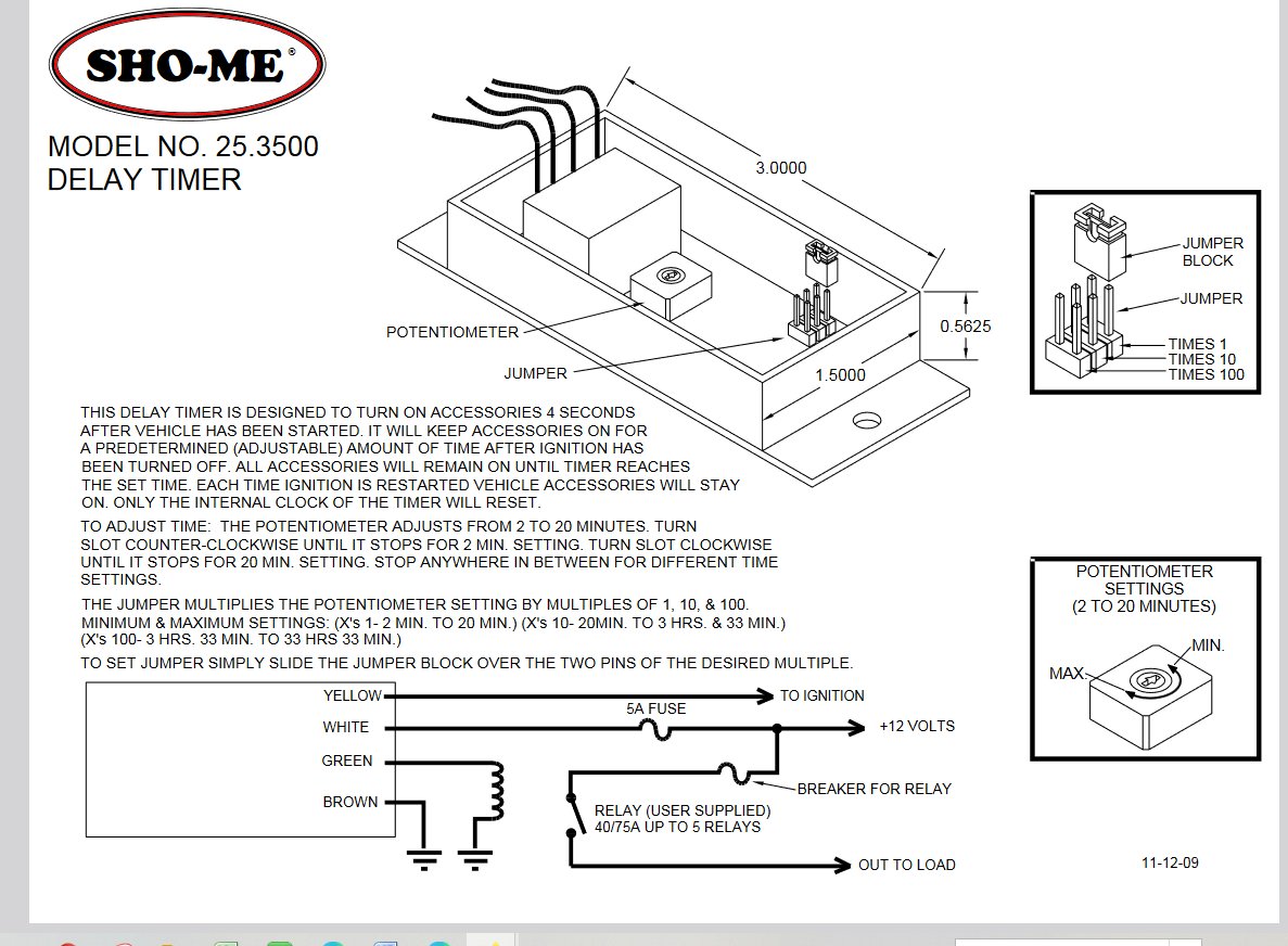

    Thanks all. Do you know how to change the settings on the Maestro? The shop set it up for me and I am not several thousand miles away. @daveeasa I don't think you would want to install a Maestro on an older truck if you do not need it (point of the Maestro is to allow factory integration for settings only accessed in the old factory head unit). It adds a different layer of complexity and expense. I would think the SHO-ME timer unit or another timer would be better. If you already have a Maestro and are just interested in not having to re-boot the head unit that would probably be more efficient to configure vs. mounting and wiring in another module. The advantage of the SHO-ME unit is that you can set up a timer for any other circuits, or even the entire accessory circuit, if so inclined.
    I didn't mention this previously but I also have a Uniden R3 detector and I really like the startup chirps-but not if I stall the MT. For me the timer works so there is less 'drama' when re-starting whether by accident or after a fuel stop or just sitting in the car for a few minutes listening to the news on the accessory circuit.
    Different rant and I am sure if will never happen but it would be great if there could be a Maestro type unit that would allow me to change settings, lights, lock timers, etc. from a tablet, laptop, or phone vs. and aftermarket head unit. I rarely change those things (more of a one time set and forget) and would like the flexibility of running old-school obsolete/legacy gear like an Alpine 7909.
