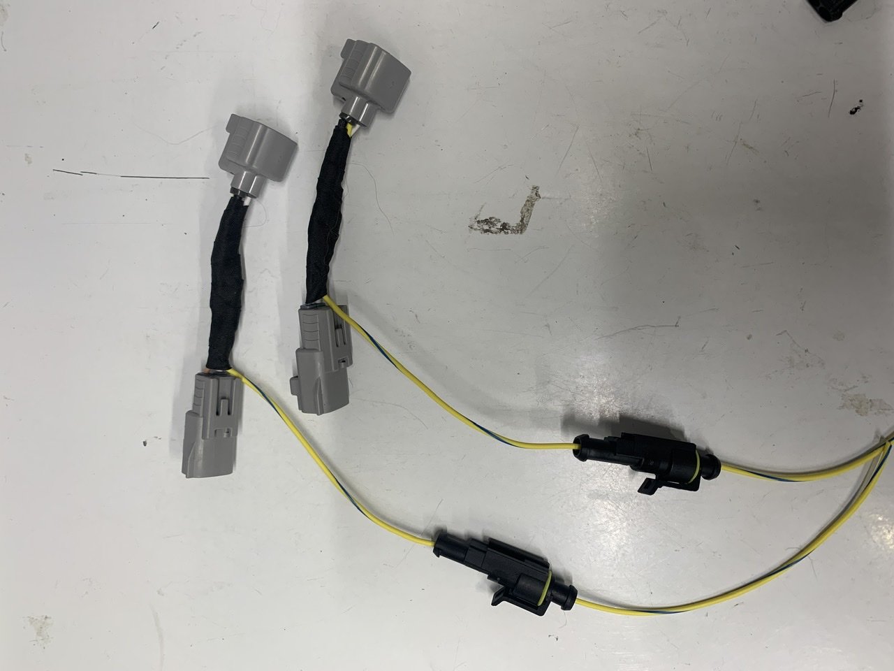

    Ok, finally got some more diodes, so I can finish...
    Project 2.2 (the rest of the project made for @5nahalf )
    These are pretty simple little taps for the front turn signals on the TRD. They are just a simple pass through with a diode on the positive wire so the strobe doesn't back feed the turn circuit, and a diode on the strobe input so the turn signal doesn't back feed it. A simple design, but should make his strobe set up work with out complications. Hopefully this will help keep him safe when he is out there helping people on the side of the road :thumbsup:

  11. Mar 12, 2021 at 1:29 PM
    #71
    5nahalf
    5nahalf I build dumb things
    Sep 22, 2018
    #267058
    10,940
    Erik
    Minnesota
    2018 Inferno Longbed
    I tested one of my turn signals with some alligator clips last night, No way some one is not going to see me.
    tonered, hirod and Tacospike like this.
  12. Mar 12, 2021 at 1:31 PM
    #72
    daveeasa
