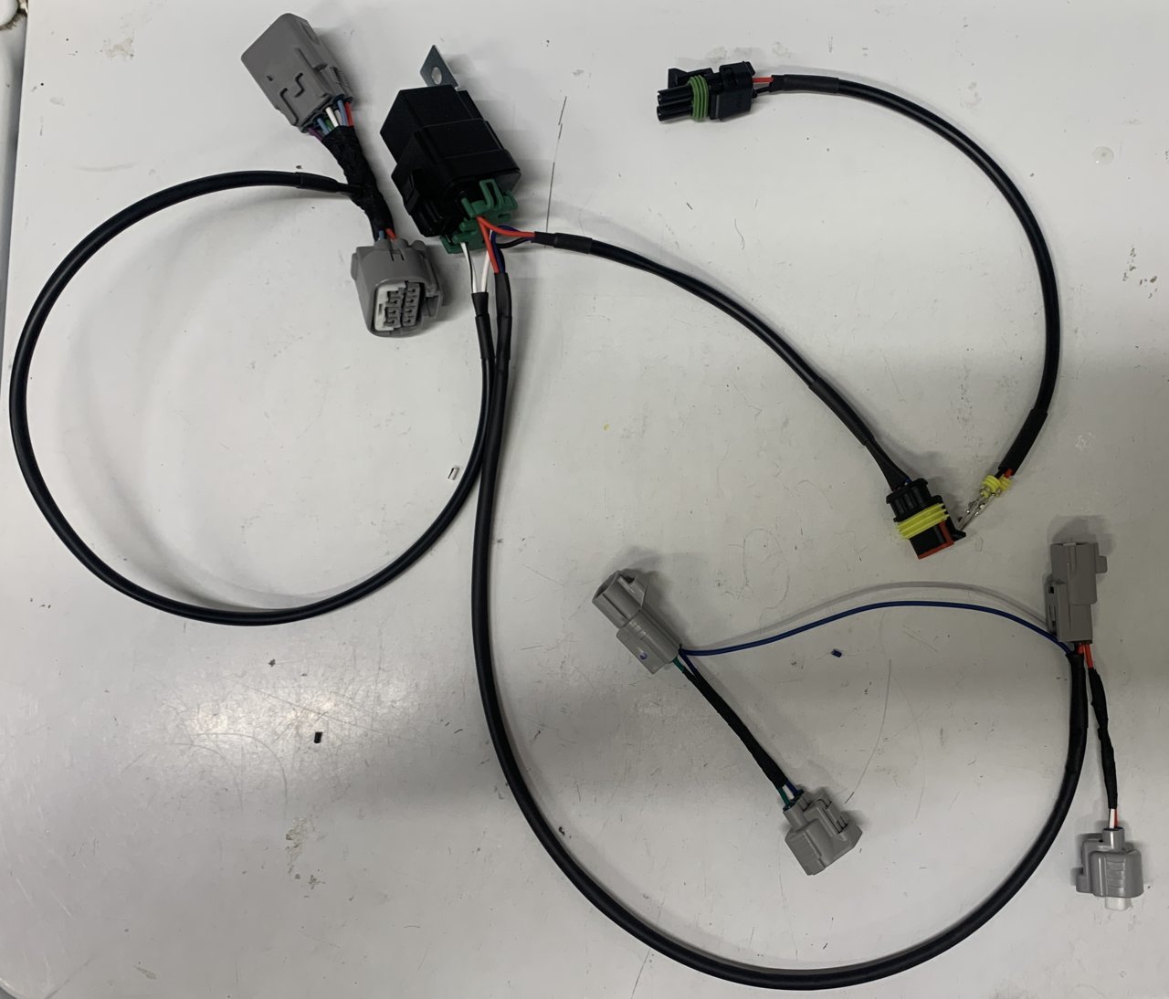

    So, prototype is built. DIR for 3rd gen Tundras. @Shellshock you’re up :) shoot me a PM with your shipping address.

    That looks awfully similar, just a sixer on the intercept?
  10. Apr 14, 2021 at 7:02 PM
    #130
    Puppypunter
    Puppypunter [OP] Well-Known Member
    Jan 4, 2020
    #315086
    2,688
    Johnny
    2019 Black SR
    8 port. The reverse is a 2 port, but different part number. Breaking the ground on this one as the lights have 2 positives going through the 8 port, but only one common ground. Also will mount lower on the frame, so the relay>taillight wire is a bit longer.

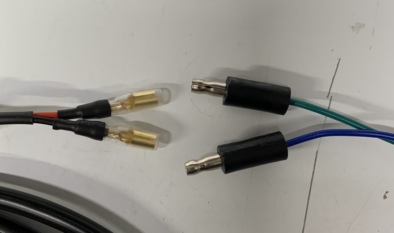

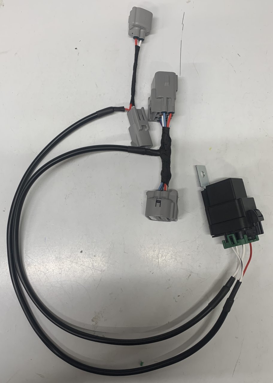

    Ok, since @daveeasa was all like “pfft... I can do DIRs in my sleep!” Here is a modified one (and the future of the reverse taps someday?). This one was made special for @memario1214 for his Tundra. It has the DIR, yes! It has a reverse tap, yes! But if you look real close, you see an extra connector there with a lone blue wire sticking out. That is a brake tap! Just when you thought it couldn’t be done, I found more crap to integrate into a harness! Anyway, the brake tap, the reverse tap, and a ground wire go to the three port connector with the red tip. For now, it will just be reverse and ground continuing on from that point, brake gets a blank plug. But... when the Diode Dynamics folks decide to ship the SSC1 (I think that’s the model? The little 2x2 light they have coming), we can change that last 10” part to activate the red backlight that memario1214 now knows he needs for an additional brake light.
    Sorry, sharing this one a little premature. I ran out of 3 port AMP male housings....
    Also, I really need to improve my photography...
