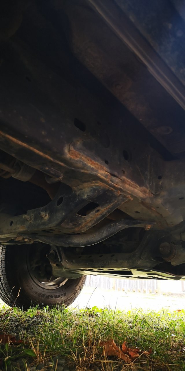

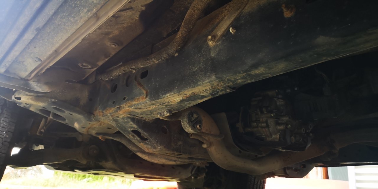

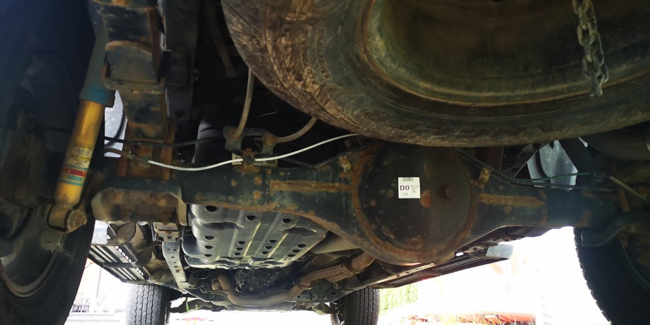

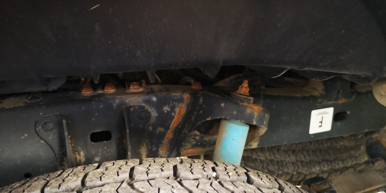

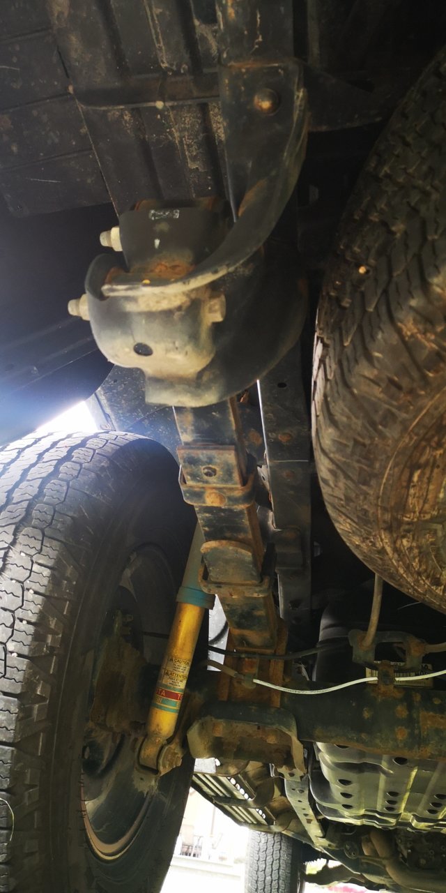

    Hello,
    I purchased a 2016 Tacoma in last October, upon first glance we noticed a thick coating on the underside of the truck. We asked the salesman what the coating was for, he did not have an answer for us and brushed it off. I thought that with winter approaching, it was in preparation for the salty roads.
    We asked the salesman if they could remove the coating for us before purchase, to which he obliged. We took a quick look underneath the next day and everything seemed ok.
    Fast forward a couple months with the truck, when taking the vehicle on logging roads, the back end would start squeaking, I took more time to look at the underside of the vehicle, only to notice the incredible amount of rust.
    I did some digging around online, only to discover the recall for 2016 Tacoma's, rust on frame. I now understand that the coating we saw before purchase was the band aid Toyota is using up until I believe December 2020.
    We are looking to address the lack of notification of the recall with the dealership this weekend. My hope would be that they would replace the frame entirely, which was stated in the recall notice if the rust is bad enough.
    I am looking for any advice going into this meeting with the dealership, any similar stories etc.
    Also, if applying the coating is the only option the dealership gives us, I guess I want to know just how bad do you think the rust is? I made the big decision to purchase the vehicle, anticipating it would last me 15-20 years...I have little confidence now which is unfortunate.
    Thank-you.

    I'll be interested to hear what others have to say, but depending on where you live for a 4 year old truck (and how many miles?) That doesn't look that bad to me. But I get it, any rust is disappointing.

    Very normal rust. Go look at other tacomas in your area.

    I mean, what can you do. Get the tsb coating and call it good. Toyota will replace the frame if it gets a hole.
    Depends where you are if that's considered bad.
    Personally I would wire brush all that rust off exept the suspension, paint, then fluid film it's not bad at all for indiana where I live. Not at all last save able long-term, but it's a ton of work.

    That’s really not too bad. Certainly nothing they will replace the frame for. Can be cleaned up and protected though.

    Agree. Fluid Film is your friend. I only see surface rust there and it's nothing to worry about if you start applying Fluid Film every fall.

    Definitely doesn’t look bad for a tacoma... it’s a lot of work, but wire wheeling and repainting is your best bet. Or you could calcium chloride your frame until a hole appears and hope your dealer replaces it...

    I live where salt/brines on the road almost half the year. That looks normal for a 4 year old truck thats rarely had the underside washed or been properly rustproofed. Another 4 years you wont see any black paint under there. Normal for toyotas, and not structural at all. That coating they knocked off was likely a rubberized undercoat. Good riddance to that. It would have accelerated the corrosion by trapping inevitable moisture against the steel.

    Don’t be upset about it, that’s not what I’d consider rusty. As others have said, you can clean it up and protect it from here on out and it will treat you well for those 15 years you dream of :thumbsup: (maybe, nobody knows for sure on the 3rd gens yet :rofl:)

    It's fine, just clean it, recoat it.

    Doesn’t look bad. I wouldn’t really worry about it.
    Also, if the dealership or Toyota has any record of the protectant being applied and later removed upon owners request, they won’t do anything to fix or replace that frame.
