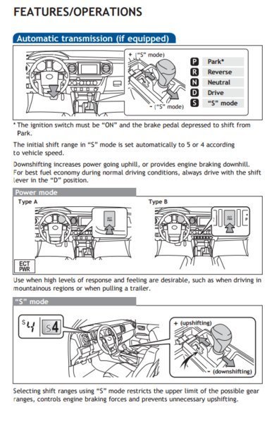

    So this is a hard acceleration from a stop, more pronounced when doing it while making a turn?
    Sounds like the delay is a combination of new transmission and traction control kicking in.
    As for running sluggish, you realize 5th and 6th gear are overdrive gears right? When the truck is in D the transmission programming will try and shift to those in an effort to maintain best fuel economy. Later programming releases reduced the aggressiveness of that function.
    I think a lot of the transmission complaints regarding shiftiness would not be so prevalent had Toyota labelled things differently. If they programmed S4 to be "D" on the transmission selector, S5 as OD1 and S6 /D as ECO and a little light turned on the dash indicating such, people wouldn't be complaining as much. They would probably use D (S4) and OD (S5) all the time and think the truck shifts fine, when they set it to ECO they think the shiftiness is normal due to the truck trying to save gas at all costs.
    But because everyone wants to set it to D and forget about it, people are complaining because in this case D doesn't drive like other cars or trucks in the past, not many have two OD gears (5th and 6th) like the Tacoma does now.
    What the owners manual says regarding the transmission.
    Anytime I know I need a burst of speed merging into traffic from an on ramp I bump to S4 and hit the ECT button.
