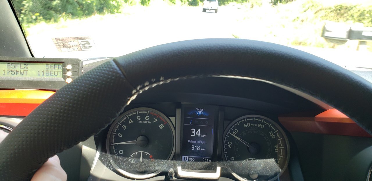

    Here's an example. Going 34, moderate throttle, low rpms... and we're in 5th gear ( upper right value on SGII). Give some beans and downshift to 4 then right back up to 5th. Totally agree with S-mode and higher revs to put down the power.
