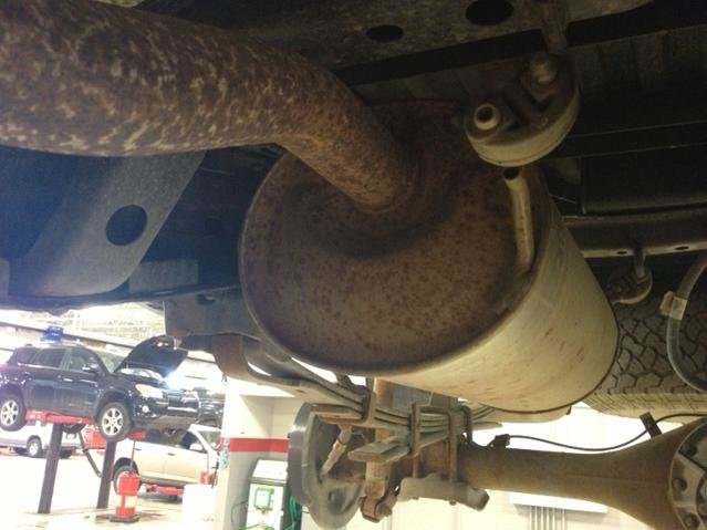

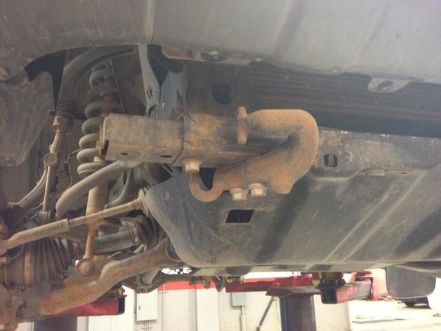

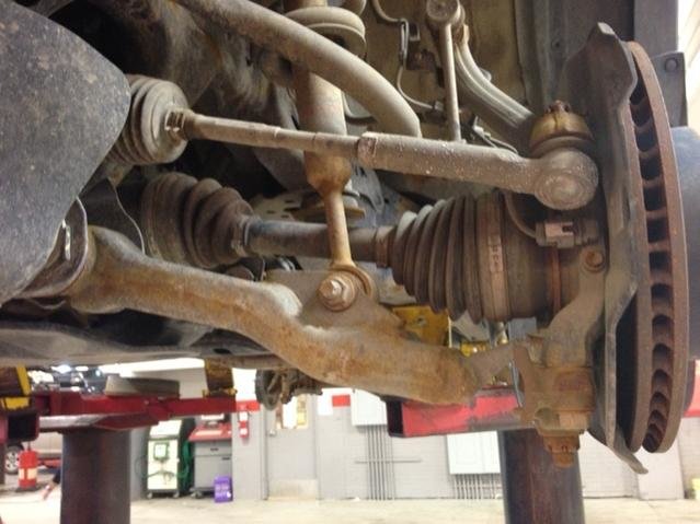

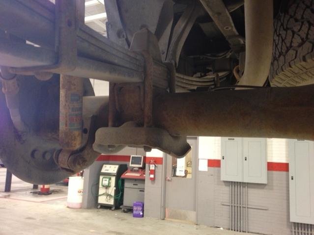

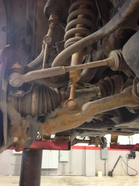

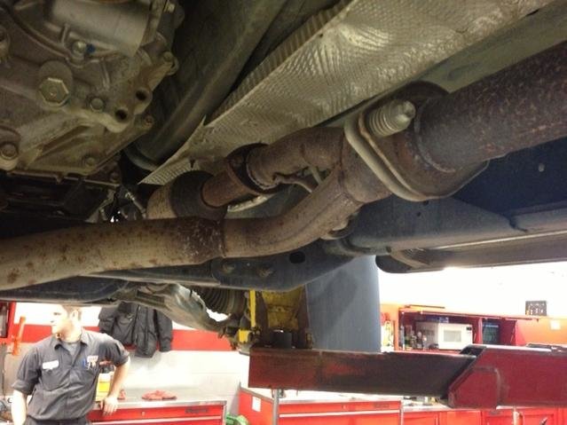

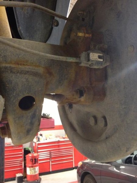

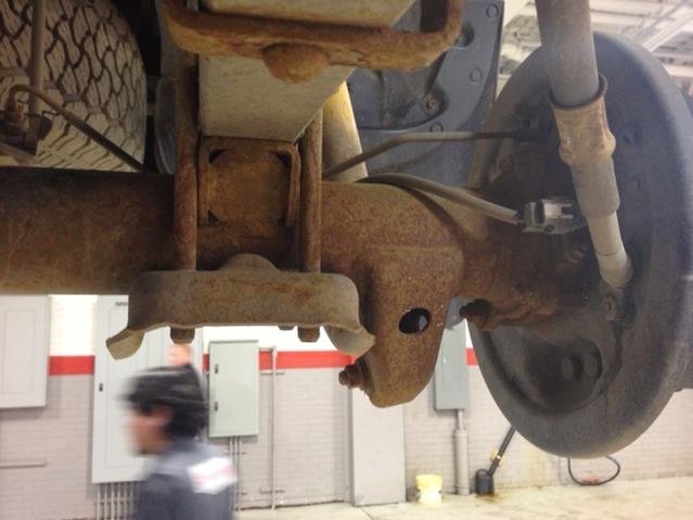

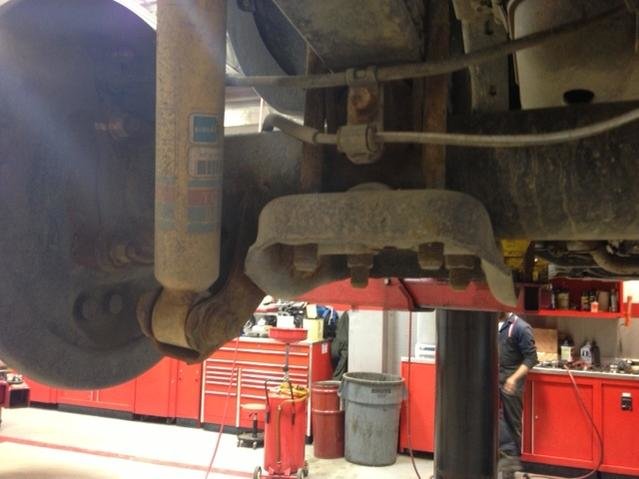

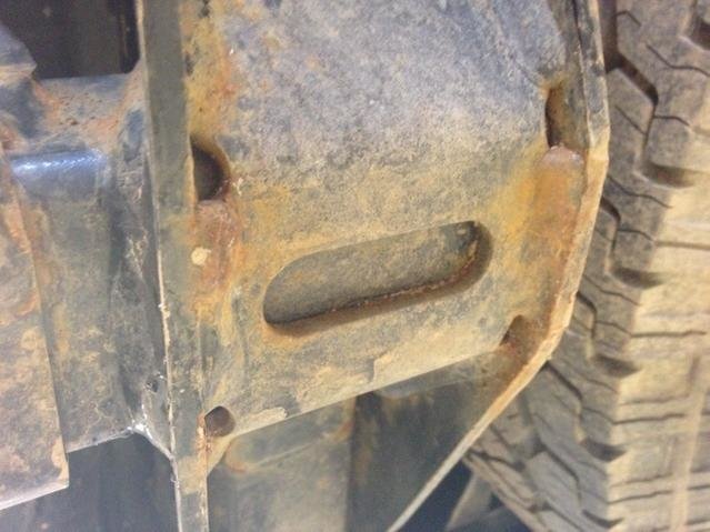

    I need some advice,
    I have been negotiating the purchase of a 2011 Tacoma and had reached an agreement based upon the truck passing mechanical inspection.The Dealership where I live (Edmonton, AB) cleared the truck mechanically, however, I looked at the undercarriage and I am concerned with the amount of surface rust on the suspension, frame, exhaust etc.
    According to the trucks current owner the vehicle has been sitting for the last six months. It is only a 2011 with ~25,000 Km's, is it normal for a new Tacoma to have this much rust? and what options would I have as a new owner to fix this issue if I do purchase the vehicle? Do you think that this rust will significantly lower the trucks resale value? Any and all advice is appreciated. I have included photos of the vehicle to give you some perspective.

  2. May 7, 2013 at 1:57 PM
    06 tacoma owner
    06 tacoma owner Well-Known Member
    Jul 31, 2012
    #83845
    1,256
    Will
    Western KY
    2006 AC super white 4x4
    4 inch lift, 6000k HIDs, weathertechs, Pioneer head unit with bluetooth, 285/70 trail grapplers, aero turbine muffler w/ flowmaster 3 inch stainless tip
    WAY to much rust for a 2011
  3. May 7, 2013 at 2:01 PM
    arlypoo
    arlypoo Well-Known Member
    Aug 21, 2011
    #62082
    45
    Arlin
    Port Something
    2005 2.7 4x4
    I would avoid this truck if I were you.

    I got a 2011 Tacoma and this is what the bottom of mine looks like. That Taco you're looking at has way too much rust.
  7. May 7, 2013 at 2:39 PM
    rickc5
    rickc5 Well-Known Member
    Jan 26, 2013
    #96166
    109
    Rick
    Whitewater, CO
    4Runner Trail Edition
    Skids, sliders, 2" lift
    OMG! Yes! Waaaay too much rust for a 2-year-old truck. Our '06 has hardly any rust at all (as a point of comparison).
    Run away from THAT truck!

    I could understand if the truck was from out in Eastern Canada. Or the truck was parked in a lake for those 6 months. That has way too much rust on it for being only 2 years old. Tacoma's are known for having rust on the undercarriage of the truck. If your truck was 5 years old then I could understand that. Being that it's only 2 years old makes me wonder where the truck was sitting for those 6 months. If I were you I wouldn't buy it. The great thing about the truck is that the km's are low and it's mechanically inclined. If you were going to sell the truck down the road after you buy it then you could run into the problem of the new people looking at it being concerned about the rust. I'm sure that it would make them wonder how well you took care of it. I would stay clear of this one and keep looking.

    looks like it was in salt water for a month, move on not worth the hassle.

    Just walk away! There is no 'fixing' this. I have a 2011 with 43k miles and have nowhere near this amount of rust, and I live in PA that salts the hell out if the roads. Just find another truck.

    Yeah dude. Find another. A 2011 shouldn't have that much doom!
