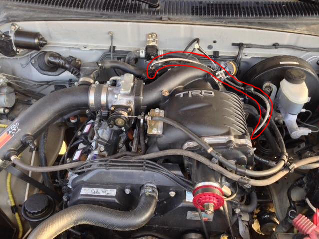

    The 2nd gen supercharger for 1st gens refers to the 2nd edition of the TRD supercharger that TRD released for these trucks. The 1st edition was grey colored and a little more boxy looking...the 2nd gen is black. The 2nd gen is the one you see more often since way more of those were sold, and are still being sold by Magnuson.
    The URD 7th injector kit adds a standalone ECU device that controls the injector and is hidden somewhere inside the cab usually. Mine is mounted/hidden up behind the glove box. The 7th injector itself gets installed right at the air inlet for the supercharger after the throttle body. You'll see a shiny metal braided fuel line going to it.

    URD 7th injector looks something like this:
    Can't help you with the Innovate stuff unless you post a picture. Why not just ask the seller?
