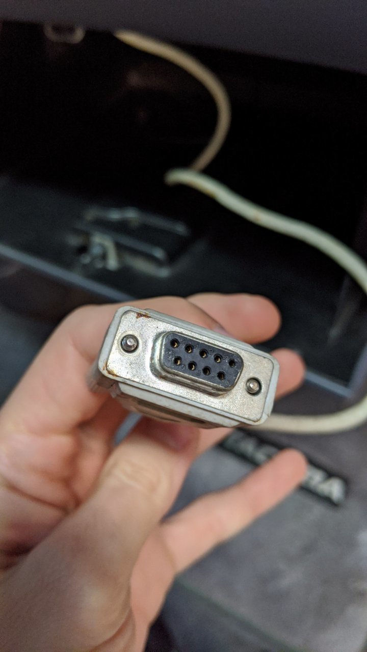

    Depending on the plug in the glove box, there could be any number of tech accessories plugged in there. When I owned my S/C 1st Gen I had thoughts of mounting an AEM FIC6 piggyback ECU to dial in fueling and would have mounted it in the glovebox due to its proximity to the main ECU. My guess it was something the owner unplugged and removed before taking it to auction.

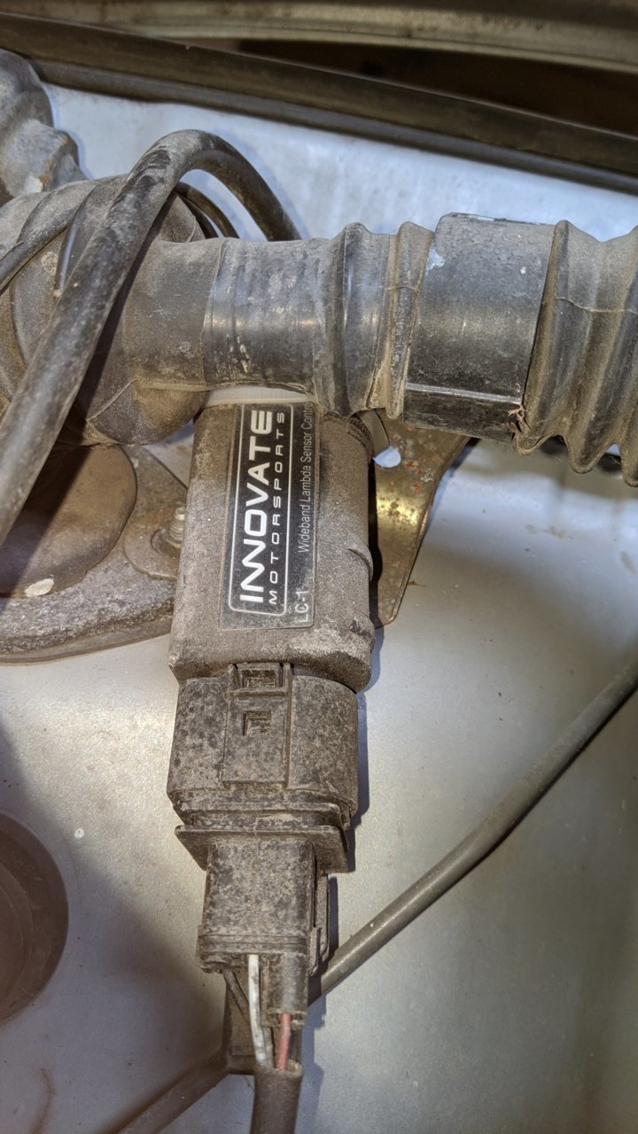

    Thank you guys! This is the information I really couldn't find searching for hours last night.
    I don't think it has a 7th injector but I will double check. I have a picture of the plug and the Innovate box which I think it just for the fuel/air gauge from what I am gathering. Give me a minute for the photos.

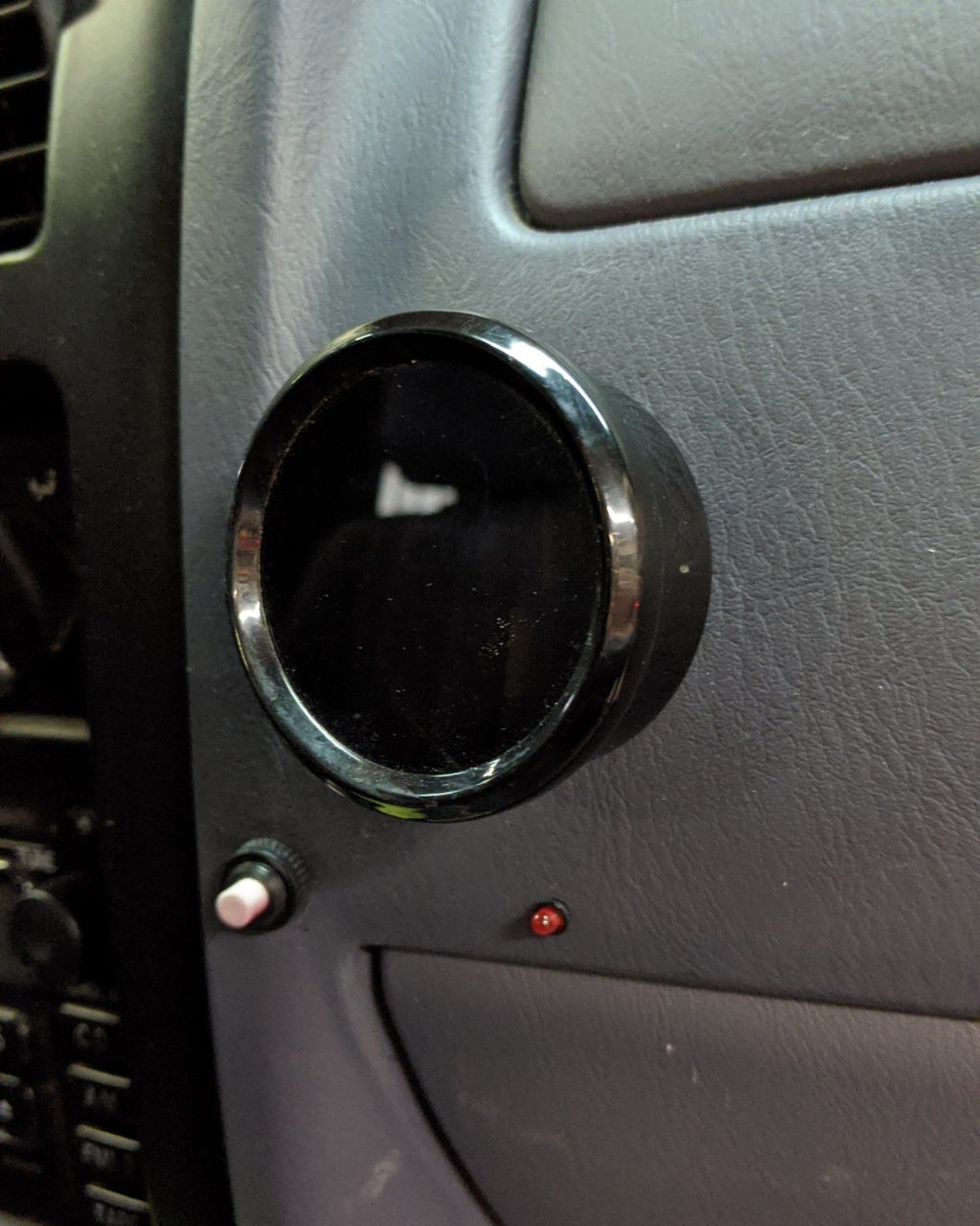

    I'm not sure what that Innovate plug is for but then again I don't have an Innovate AFR gauge, I have an AEM one.
    Do you have a pic of the dash? The gauge should be somewhere on the dash usually next to the boost gauge. Some people put them on the steering wheel or by the radio controls though

    Didn't think I did, but I do!

    There is no name on the gauge but it lights up blue.

    I'd have to see what it displays to know for sure...but it looks like it probably is an AFR gauge. A boost gauge will have a needle usually and the AFRs are usually digital displays.
    In closed loop you want your AFRs to be at or near 14.7. Once you start hitting boost and especially when you get into open loop (wide open throttle) you want to see that number in the low 11s - 12s depending on boost. If you're in open loop and your AFRs are still around 14 then you're running lean
    Understanding AFRs in detail is a whole 'nother topic though and varies on each setup but that's it in a nutshell

    I had an Innovate AFR gauge that had that same serial port (or whatever it is) plug. I believe it was an older way to data log AFR's.

    quick google search shows thats an older version of this:
    https://www.innovatemotorsports.com/products/lc1.php
    a Wideband Lamda sensor - something like an additional O2 sensor for monitoring.
    dont know what that plug is though..
    EDIT: the serial plug comes with the LC-1 kit
