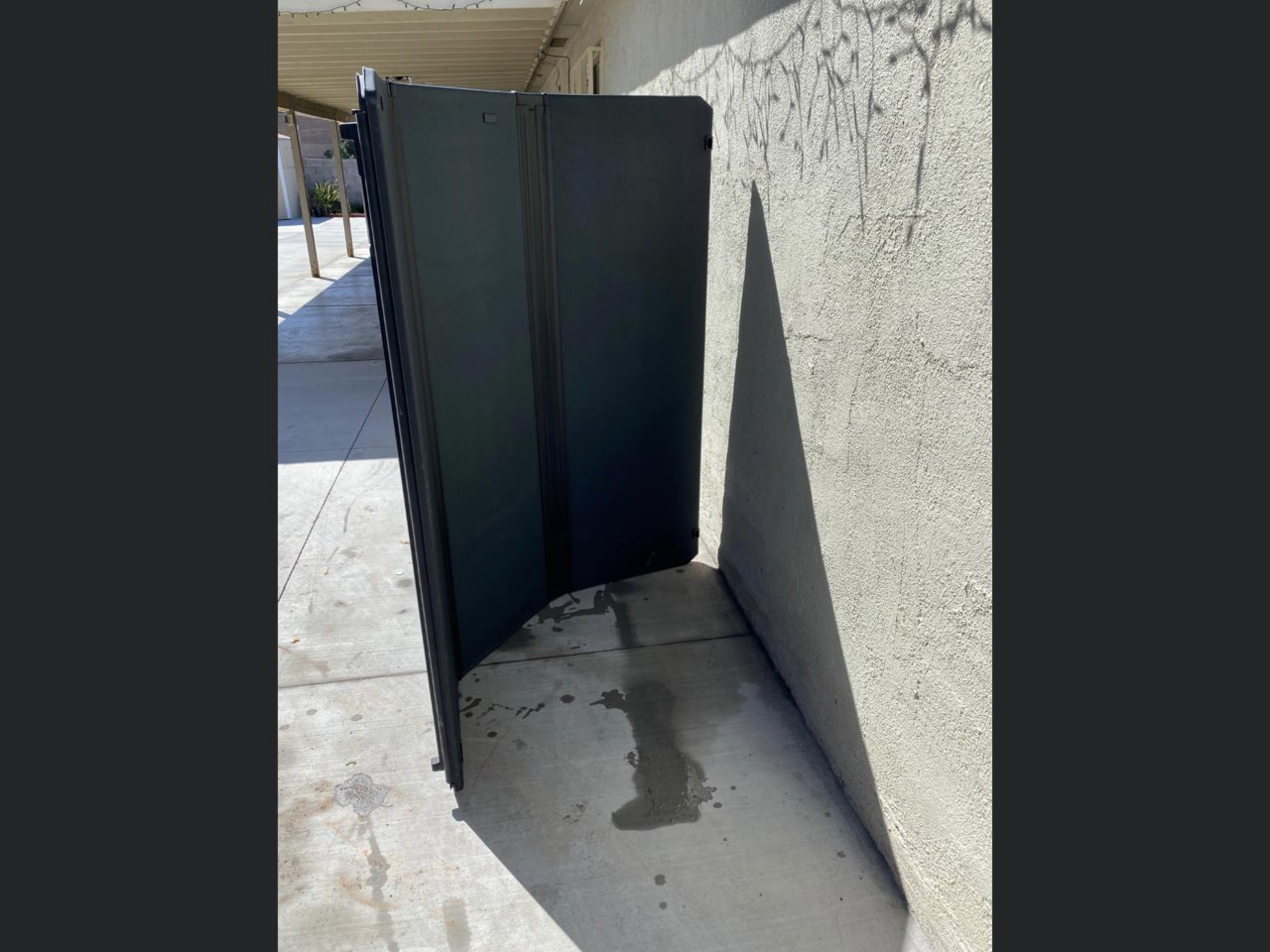

    99D10D4F-2091-469F-A8EA-D5E6EC51329F.jpg Hello TW, I am new so i apologize if this has already been answered. I recently purchased 2020 Voodoo Blue Taco OR. Unfortunately it did not come with a cover. I found one on FB marketplace but i want to make sure that i get all the hardware needed to install. Can you guys tell me what hardware is needed to install the cover. Any help is appreciated.

    You should check out their website, they likely have a parts list and installation instructions that will tell you exactly what you need. It's not unusual for people to lose a part or two, especially when they are done with something. If it's a Toyota cover you might even need to change the tracks but I'm not sure.

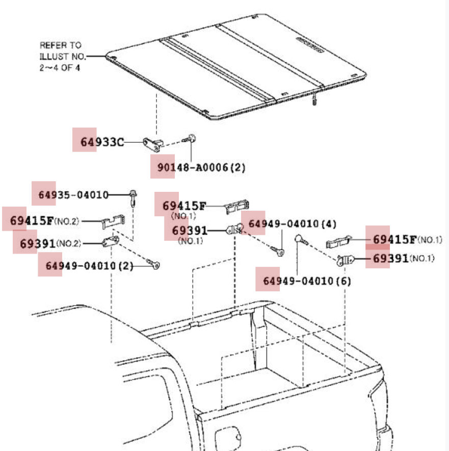

    You need the cut side rails and the items below. Hope this helps.

    Ask the seller if you can swap bed rails with them to go with the cover as part of the deal. Then you won't have to buy anything.
