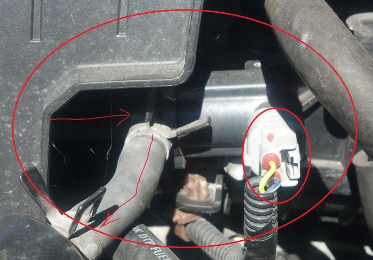

    Top, drivers side of engine, more towards the rear/firewall side of things. Has 2 vacuum lines, one to the engine that is mostly out of sight except were it connects to the VSV and one coming out of the VSV into the open space between engine and fender. The latter runs back to the evap canister at the fuel tank.
    So... you'll see two vacuum lines and a small wire harness on it and one bolt holding the unit on. I'll try to get some pics for it tomorrow cuz I know I'm not doing a great job of describing it here.

    Here's my first attempt at putting some pics on this forum, see attached...
    The purge VSV has the red highlights. On the close up pic, I added some red lines to show the route of the vacuum lines and a circle to highlight the wire harness. The one bolt holding this all on is below the wire harness, so it didn't show up in the pics.
