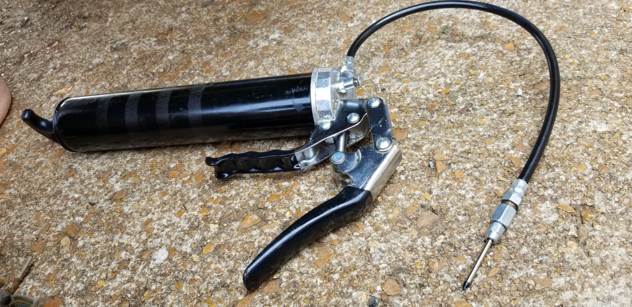

    Pry open the CV boot clamp and shoot grease under the boot with something like this: :cool: https://www.homedepot.com/p/Lumax-S...llon-1-1-2-in-Long-with-Cap-LX-1416/302545005
    Replace the CV cinch-style clamp with a worm clamp (which is commonly used for the inboard CV boot slide mod).

    I literally just bought a cheap kit from Walmart and it came with the needle attachment. They really aren’t hard to find...in real life.

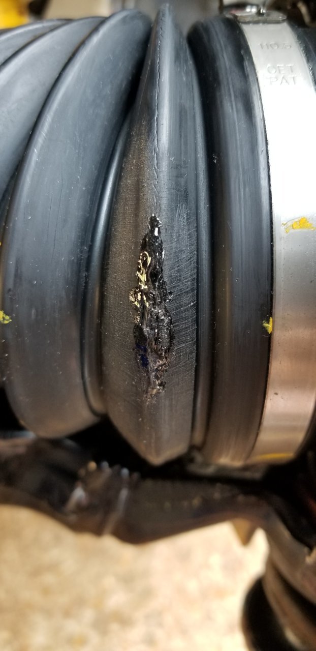

    UPDATE:
    I burned the purple tank top.
    Okay, so i cleaned the boot well enough to eat off it. Drove it a bit, and there is a TINY hole in the outer ridge of the boot, and it's spitting grease every so slightly. CRAP.
    I read a ton of posts on cv boots and i came up with a plan. It needs to be replaced. I get it. The offending boot is on the passenger side. I have a 3" lift and expect to wear out the inner boots sooner or later AND i will likely need the ECGS bushing mod sometime. This will require pulling the drivers side axel. So I'm gonna put this boot change off as long as possible and do it all (boots and bushing) at the same time.
    And I'm cheap (frugal).
    So it's getting patched. I'll use a needle on the grease gun to fill the boot back up thought the offending hole. Then a small squirt of the best rubber cement ever, Barge contact cement. Its what shoe makers use and what glues the Muppets together. Then i will cover that with a small piece of gorilla tape and let the experiment begin!
    I know, I know. Its not the right way to do things. Blame it on those guys the venture off the paved path and poke holes in their cv boots while wheeling. Somebody mentioned they got 20k out of their duct tape patch. But hey, what do I have to lose at this point? I'll keep an eye on it and see how many miles we get out of my MacGyver Patch. Will keep ya posted on my success (or failure).

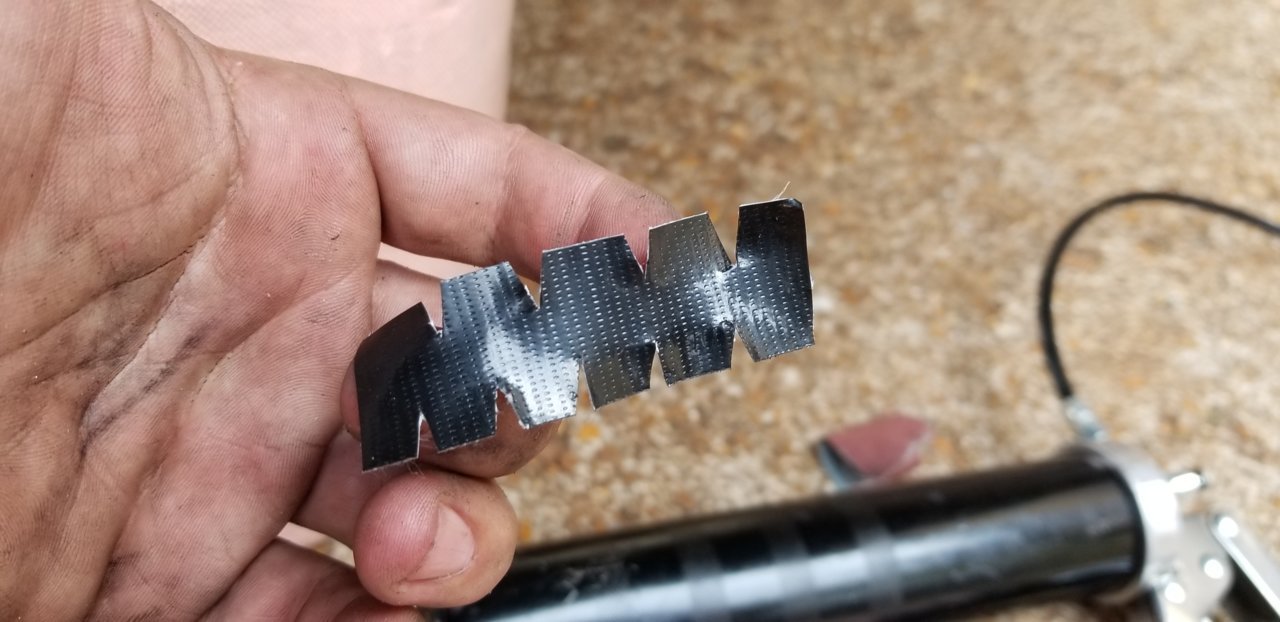

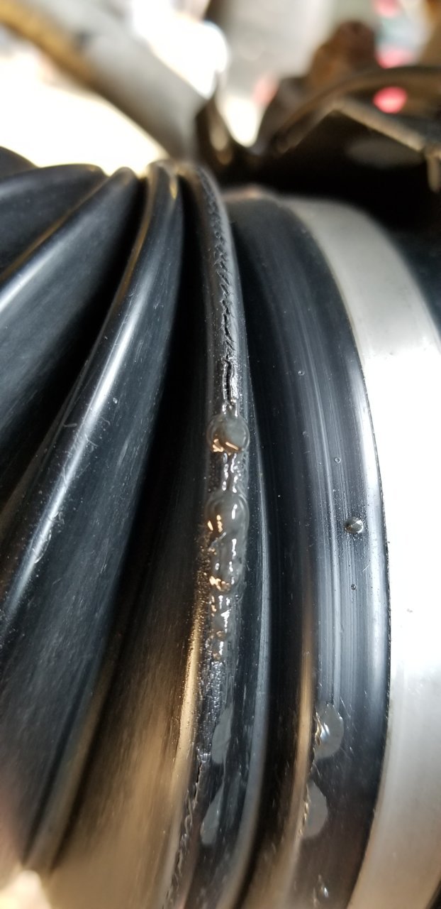

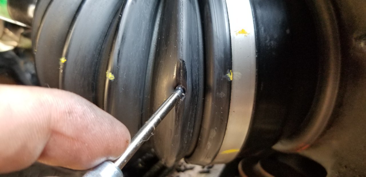

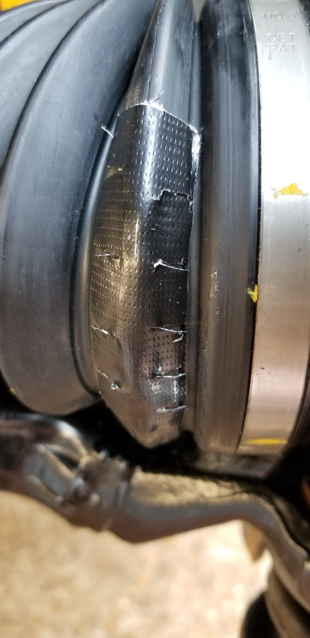

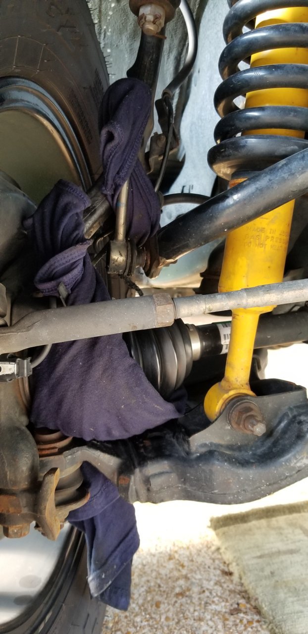

    Well hell. Heres the janky MacGyver Patch.
    First, filled with grease and cleaned. Then lightly scuffed. Then cleaned with denatured alcohol. Then glued with contact cement, let dry. Then covered with gorilla tape.
    Yep this is sketchy buisiness for sure. But i got nuthin to lose. Lets me know what you think; snarky, complimentary, or otherwise. I'm a big boy, I can take it. 20190906_115238.jpg 20190906_115823.jpg 20190906_115907.jpg 20190906_120238.jpg 20190906_121045.jpg 20190906_122848.jpg 20190906_123031.jpg

    So your time of deep reflection is over? Like you said nothing to lose. I like it. Have found remanufactured CV shafts to not last long.
  19. Sep 6, 2019 at 12:22 PM
    #59
    Jaypown
    Jaypown Well-Known Member
    May 1, 2018
    #252200
    706
    Justin
    NE Ohio
    2020 Tundra SR5 Crew Max TRD Sport 4x4
    Nothing to lose. Worth a try! It's not like it can do more damage on other components since it's a sealed (or not sealed) unit.
