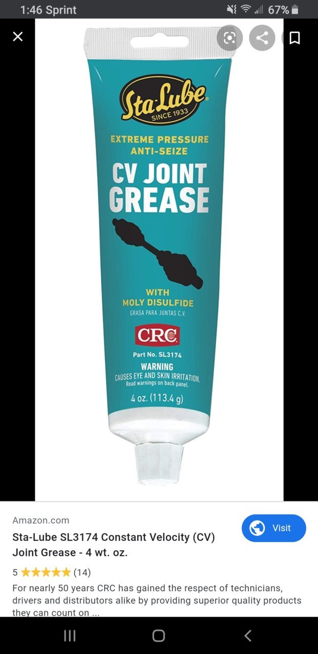

    What kind of grease did you use?

    I used this from O'Reilly's. It's a 4 oz tube but I think I could have used more, maybe even two tubes if I'm being honest. A bit was left in the grease gun and grease gun hose. Any cv joint grease should do.Screenshot_20190907-134650_Chrome.jpg
