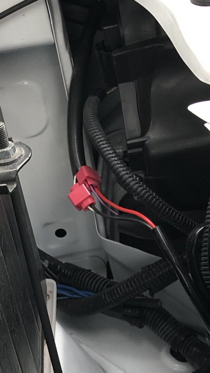

    Trying to put the red wire from my grille light to the marker lights. However I cannot find the damn purple wire. Any help would be amazing. Thank you

    Driver’s side its in a black plastic sleeve...remove the bulb socket from the parking light to confirm and trace it back to an area that’s easier to tap in.

    Thank you. I will attempt it tomorrow. as for now just connected it to the headlights. rather connect to marker lights
