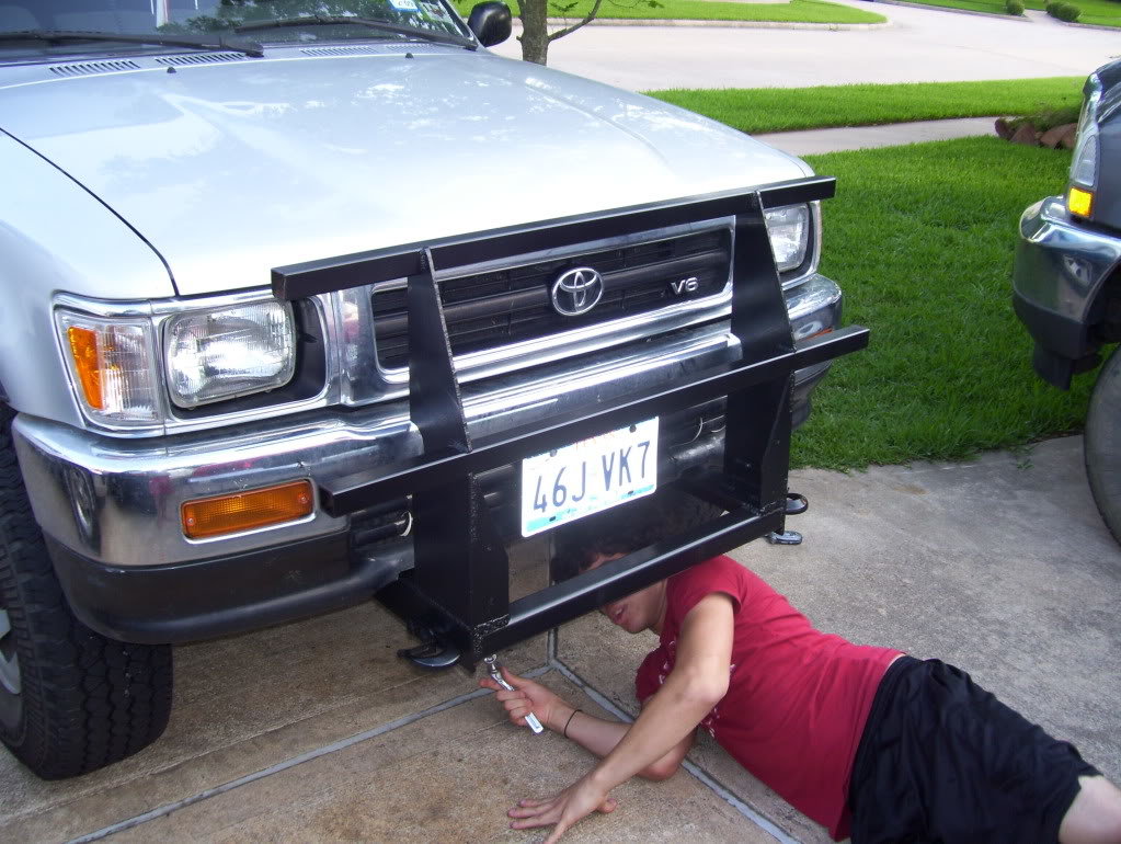

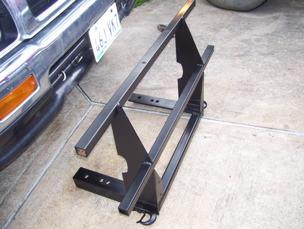

    Home made? This is what my rig had before i had my prerunner bumper on. It was pretty strong!
    I know it's an older pickup but it's just an idea.

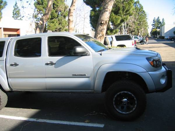

    This was the pushbar i built on my old taco, it was pretty freakin heavy cuz i wanted to make a real pushbar not just a light bar, i box welded the two arms that come up and then welded the pipe across inside of the boxed arms. I mounted them to 1/4" angle with lots of supports that could bolt to the frame bars where your tow hook is now.
    Also had support bars going through the lower grill that bolted to heavy duty angle brackets that came up from the frame.. i really wanted to keep it when i sold my truck but i sold it too fast to get the 4x4. plan on making a similiar one soon if i can find time.

    Nice setup. Yes this is what I'm hoping someone out there makes retail. Looks good and has the strength to push and not be just for looks or lights. Unfortunately I don't have the time or skills to fabricate something myself.
