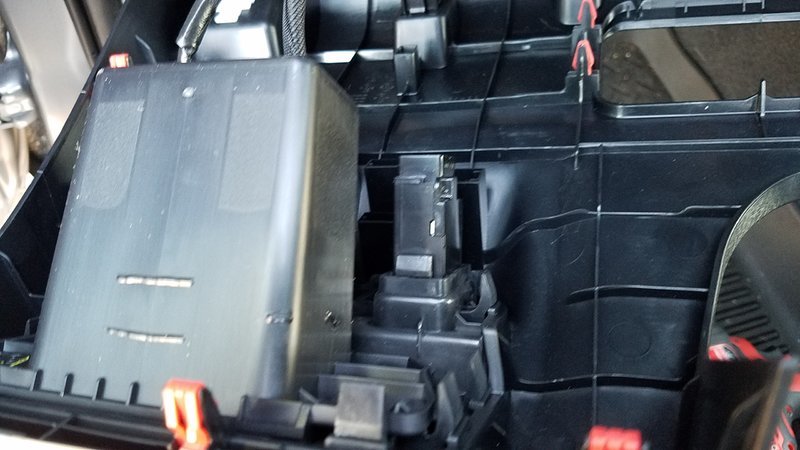

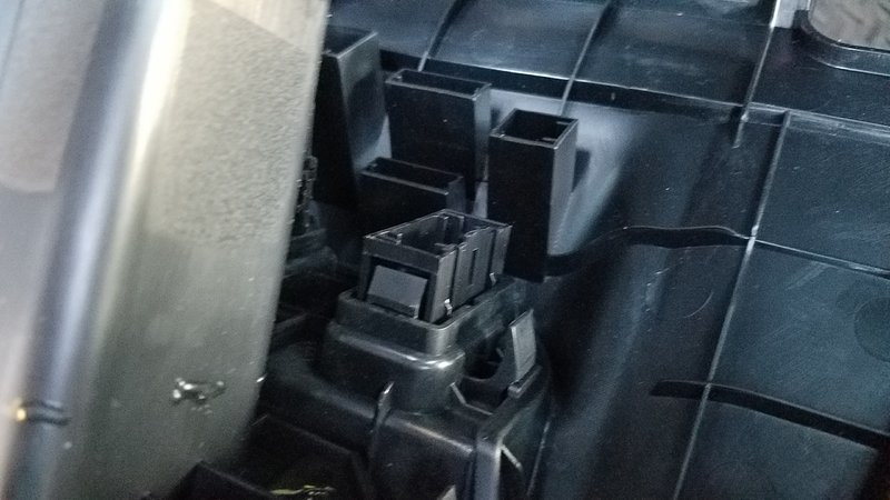

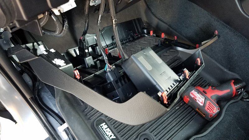

    Install instructions:
    Start out with knee-panel removed/hanging.
    (Pull up on door-sill to remove. Then remove push-nut on rear of triangle-y piece, pull triangle piece towards center console to remove. Remove 3x 10mm bolts to release knee-panel. Pull knee-panel away from dash slowly/gently, undoing each clip (there are lots).

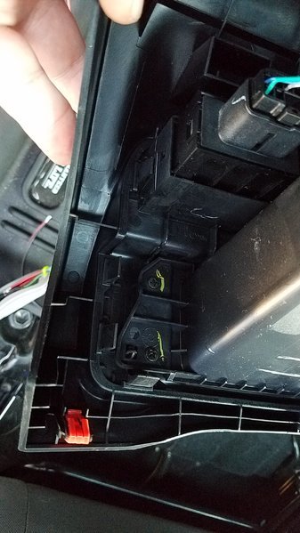

    At this point, you will either remove a switch blank, or the cubby. The switch-blank is lightly retained by clips. Push them in and push the blank out of the front of the panel. The cubby is held in with 4 phillips screws. Remove them to remove the cubby.
    Switch blank rear (it's the one without wires)
    Cubby Screws

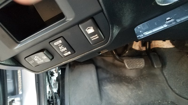

    Either insert the new switch from the front of the panel, or install the cubby-replacing faceplate. Should end up looking something like this:

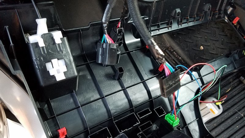

    Plug the harness(es) into the switch(es). The order isn't important if you have more than one switch. It'll all work the same.
    Now, unplug the two plugs that have been holding the knee-panel up for most of the day.

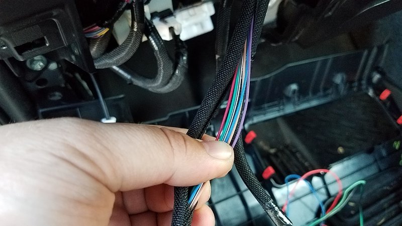

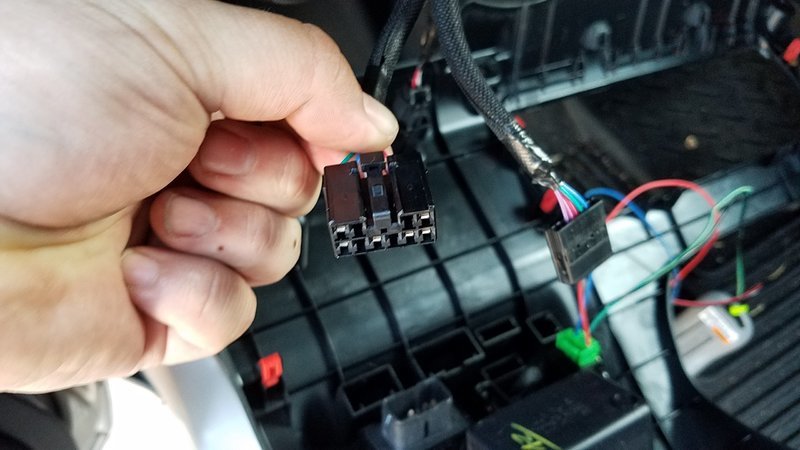

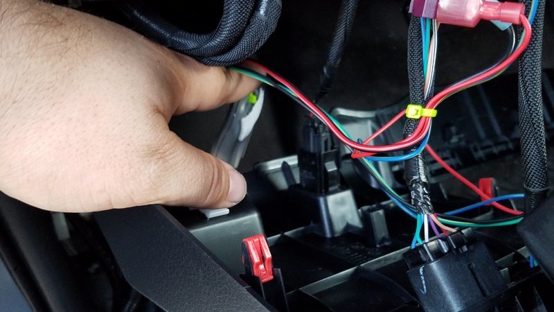

    Mainly, you're looking for the wire harness that hooks onto this plug:

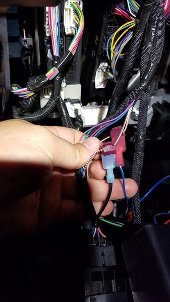

    Remove the second-set of electrical tape from the wire sheathing to access the internal wires, like so:
    Install the t-taps (by setting the wire inside the metal "u" shaped part and closing them.

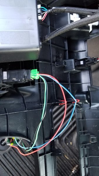

    You will need to install a T-tap on the following colors:
    Tan
    White-Black
    Stolen T-Tap Installation Video:

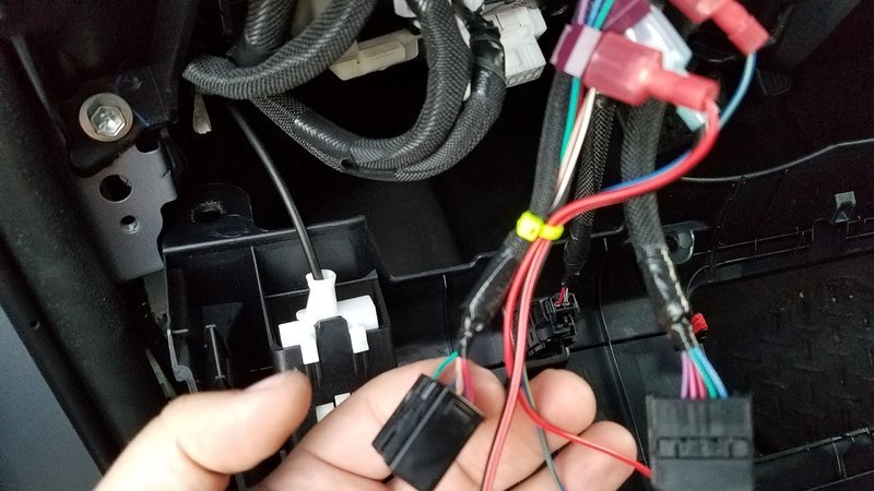

    Slide the connector from the black wire of the remote harness onto the tap of the white-black wire on the switch harness.
    Slide the connector from the Blue wire of the remote harness onto the tap of the tan wire on the switch harness.
    Add zip-tie as shown for strain relief:

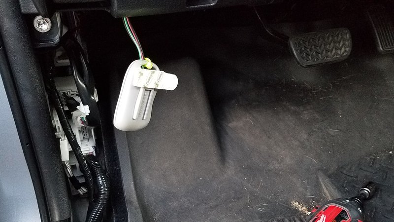

    Route remote-end as shown:
    Re-install knee-panel. Remote should be hanging like this:

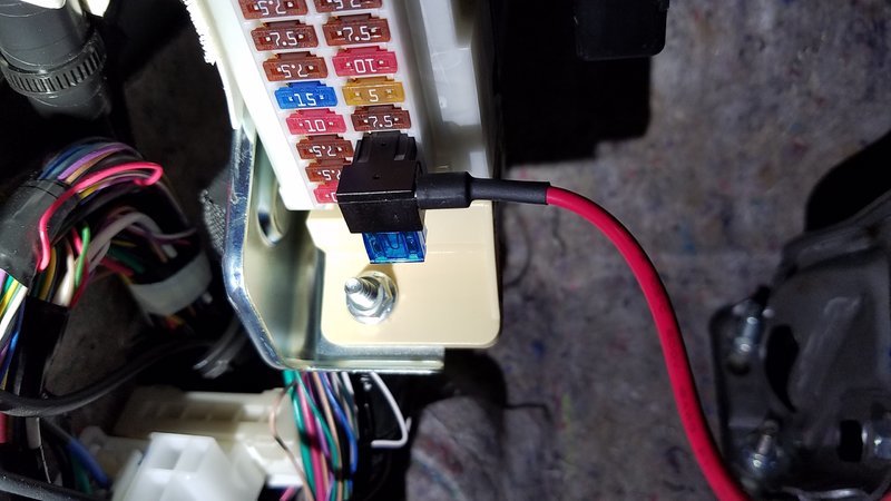

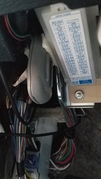

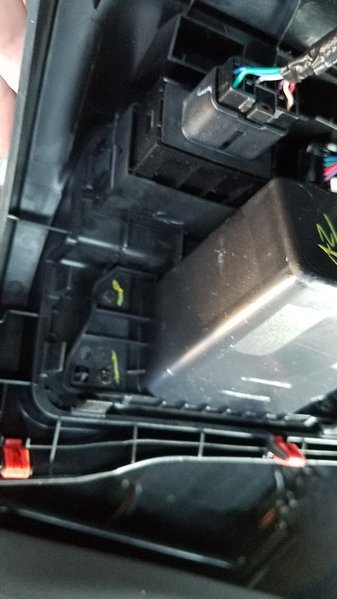

    Insert add-a-fuse into fusebox location. Put the removed fuse in the empty add-a-fuse slot, install oriented as shown. If you want the opener to function always, put add-a-fuse in thr blank power slot. If you want it to operate only with accessory power, install into an accessory switched fuse location (like shown in the picture).
    Remove the backing of the command strip, and press into the side of the fuse-box for 30 seconds.

    Final installation position of door opener:
    Enjoy:
