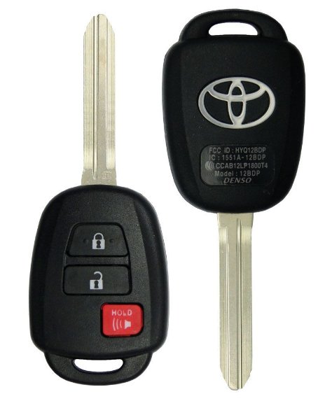

    Give me a key or give me death.
    This is a major reason I went SR5, when I looked at a TRD and saw the push button I was like ... thank you no.
