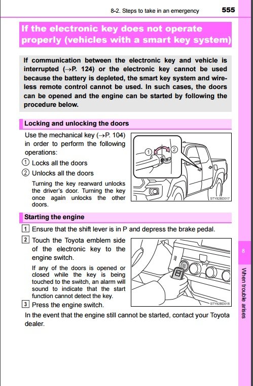

    The key inside the fob is for the glove box and driver side door so you can at least gain access to the truck in the case of your FOB dead battery. My worry is having a truck with a charged battery, but no way to turn it on because my keyless thing wont respond with my push button.

    Push to start is not a new technology and works just fine in the last 4 vehicles I have had. In the event the FOB battery is depleted you simply put the Fob next to the button. Prior cars had a way to pop the button off or had a glove compartment area where you inserted the fob into in order to get it to start. In the last 8 years of owning a push to start vehicle, it has never been a problem and probably won't ever be either. It's nothing to worry about.
