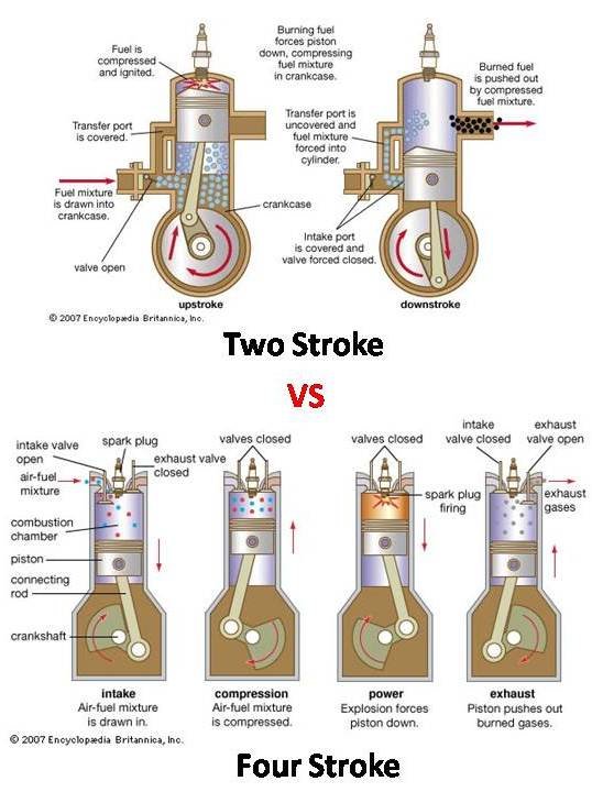

    EZ mod:
    Get rid of all timing components (camshaft, timing chain, sensors, etc.)
    Replace all valves with reeds
    Drain engine oil, 2 stroke crankcases air lubricated by the pre-mix
    Weld an expansion chamber on the exhaust
