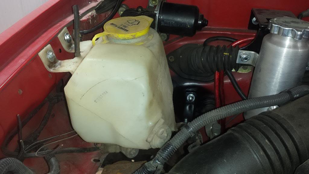

    Got tired of fixing cracks on the stock washer reservoir, so I removed it and put in this one I picked on Amazon http://www.amazon.com/gp/product/B00495UQT2/ref=oh_details_o00_s00_i00?ie=UTF8&psc=1
    Very simple to install: An L bracket to mount it against fender, splice 2 wires (needed to add about 2' of wiring) hook up hoses, I used existing ones after flushing and blowing them out. You could put it where the original reservoir was with some minor changes, but I found the way I did it easier. It fits and works perfect, total cost...$20.75

    I don't what's going on in regards to you not seeing the pics, it comes up fine for me, these are all the photo I have and they are just different views of the same thing hope I'm doing this right
    This is where the original tank was, the new one would fit with an added bracket or two.

    I'm pretty sure it will fit where old one went, just a different mounting needed, and 1 less splice.

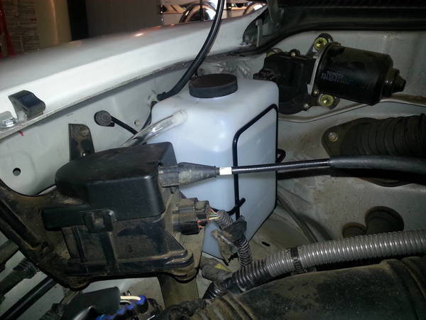

    on mine because of the SAS I found out that a washer reservoir out of a jeep Cherokee fits right up by the firewall almost perfectly right in line with the wires that go to the sock one and right by the feed line for the washers.

    here is mine out of my old Cherokee. grabbed it out before I scrapped the old rig it even has 2 pumps one it so I could do something with that.
