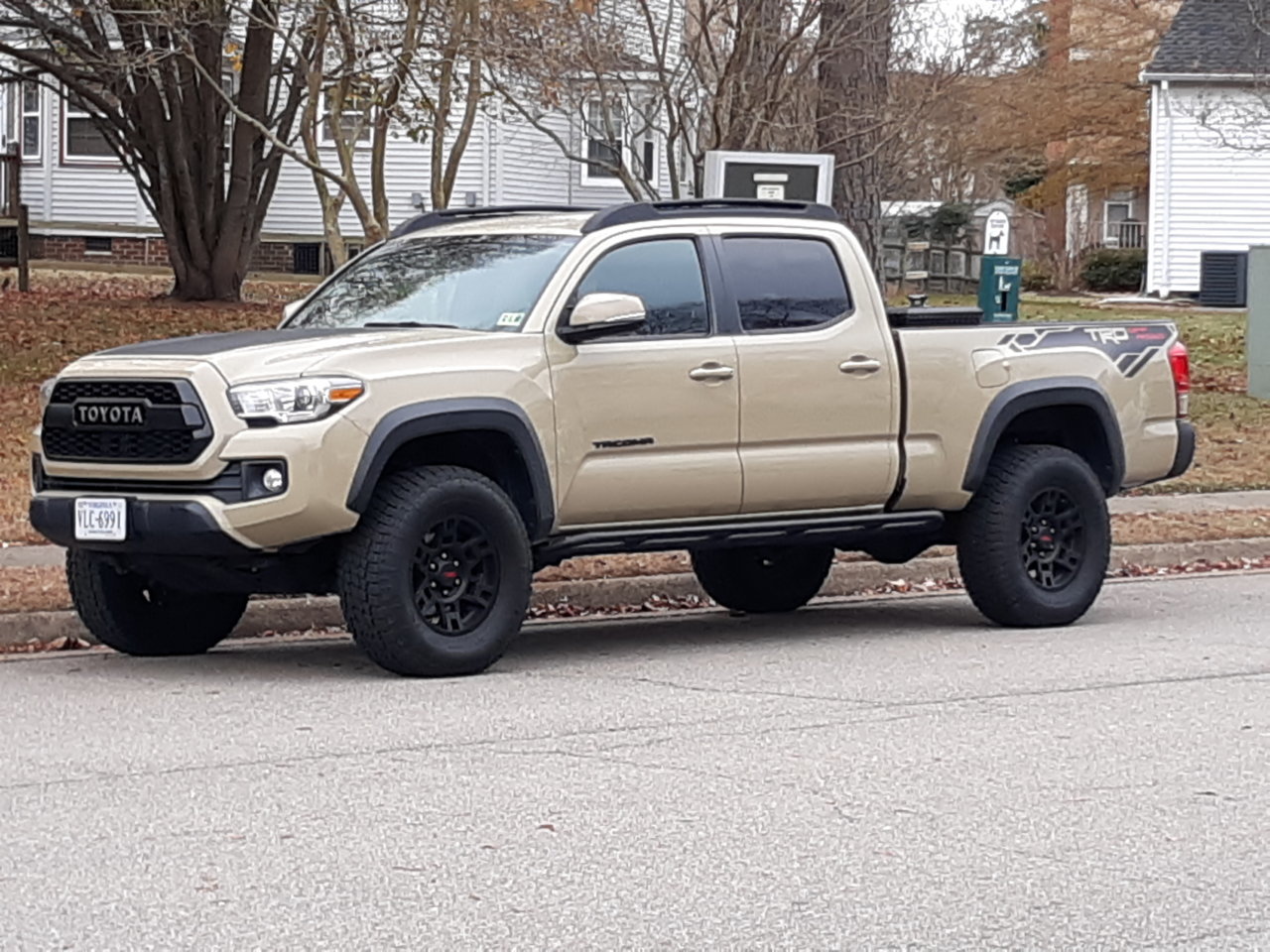

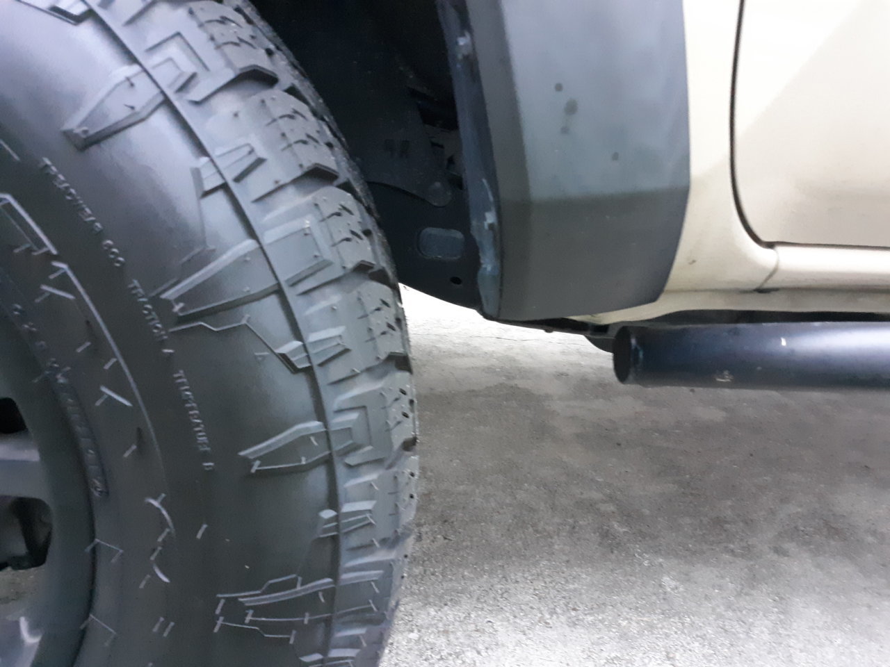

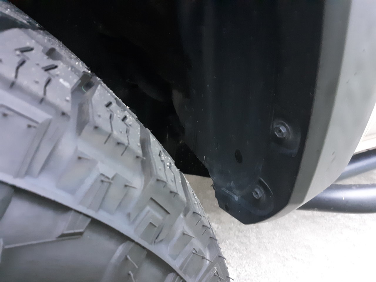

    It will depend more on the wheel offset and alignment more that lift. You need to get the tire as far away from the cab mount at possible when the wheels are turned. This is the clearance I have with a CMC, trimmed fender liner, 2 inch lift and an aftermarket UCA to help with alignment. Lift won't help that when the wheel is compressed into the wheel well.
    Here is the clearance with wheels pointing straight.
    Two inch lift with 285s.

    I like how the 2" inch lift looks. thx for this, most on youtube are 3" that is why I wanted to see the comparison and what kind of trimming will be done. thx brodie!
