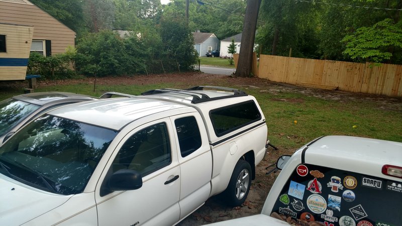

    I have an ARE camper also, and picked up 2 Pathfinder racks today for $50. I intend to eventually mount one of the racks over the cab as well. For the camper shell rack I took 8" off. I haven't attached it yet since I want to take the shell off before measurements and drilling. It's just laying up there for the pic.IMG_20170430_193207217_HDR.jpg
