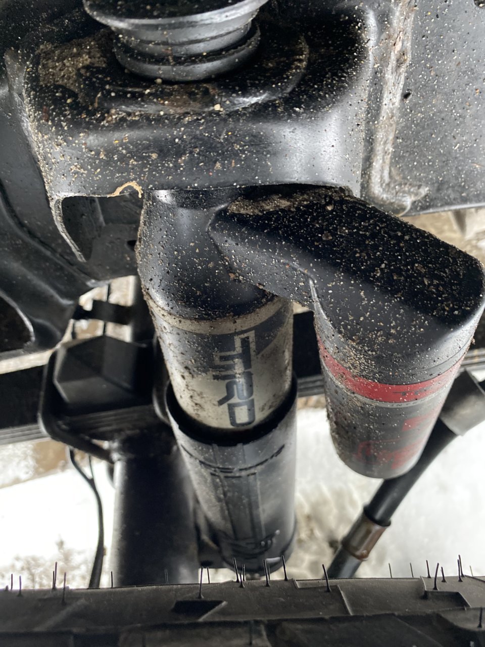

    You do know that’s installed upside down don’t you?

    61
    2017 TRD Sport 4x4
    Why would it be upside down? Looks correct to me

    You've probably been ripped off then. Honestly looks like all he did was chop that shock tower to fit the shock in there. Rear leaf pack looks stock

    Simply look how they are installed from the factory. But the plastic boot that’s supposed to protect the shock from dirt & shit is now acting like a cup to collect it all should have been a give away.

    That's not correct

    This is how they're installed from the factory on a 4runner. I can understand why you'd think this is incorrect, it is the opposite of how the Tacoma rear shock usually mounts. But that boot has cutouts in the bottom to allow for debris to escape.

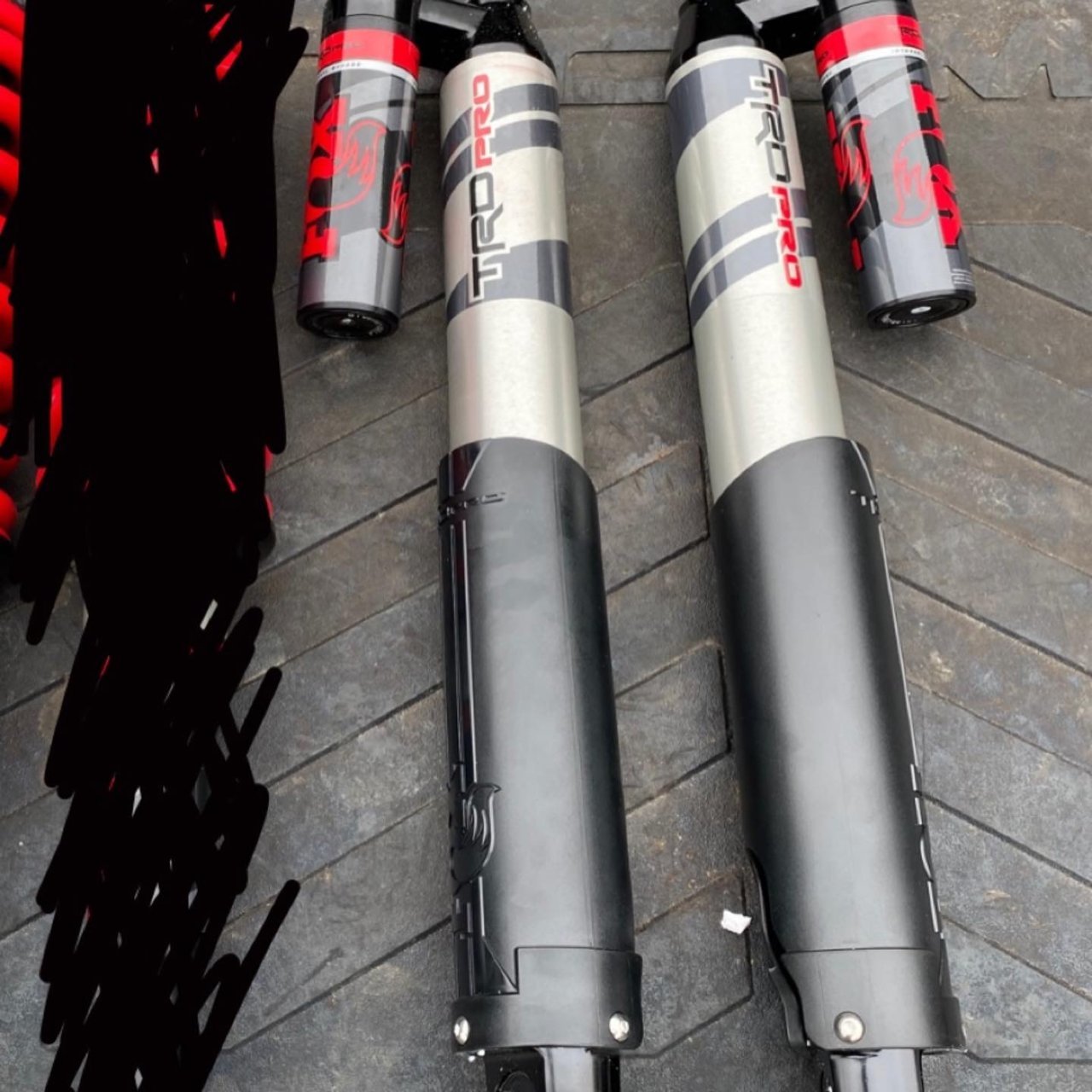

    Buuummp. Also interested. Just purchased a set of trd pro suspension off a 2020 4runner trd pro. The front coilovers bolt right up just fine. The rear shocks need that bushing. Curious as to how it worked out

    got a set of Trd pro from 4R…
    front: everything seems okay, the bottom shock bushing sleeve needs to be trimmed a little to fit into the bracket on LcA.
    rear: for those of you thst don’t want to swap out bushings you can enlarge the mounting bracket for the lower shock bushing. Use bigger bolts. Don’t use stock bolts as it leaves too much movement between the sleeve. It probably will break the bolt eventually. Also you have to trim down the sleeve as well.
