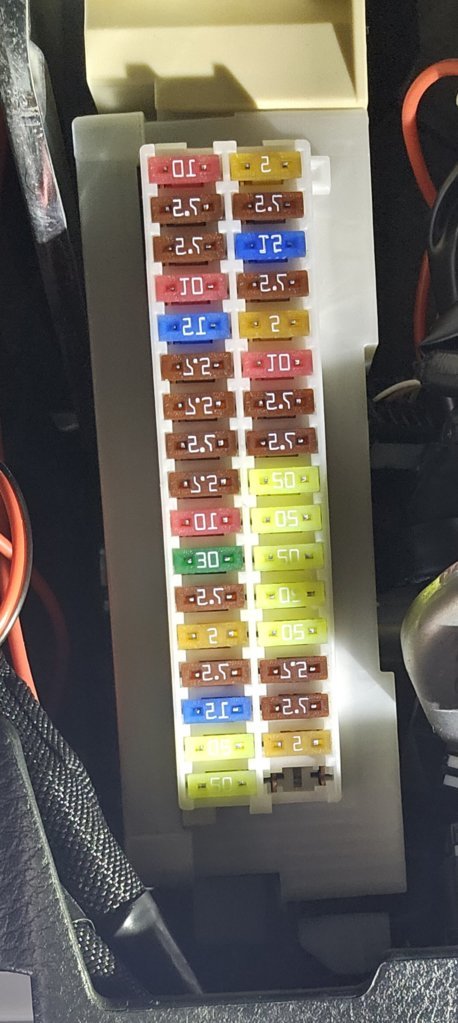

    One more question since you're pretty knowledgeable, here is my fuse panel..I dont see the 30a locations of where to tap. Am I missing something? Sorry if it's obvious im still learning this.20250518_113544.jpg

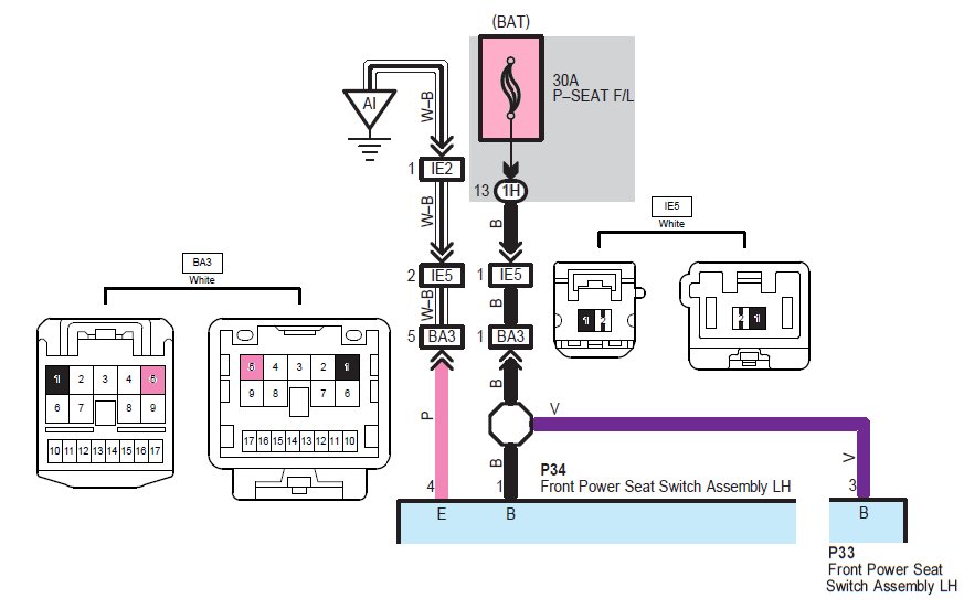

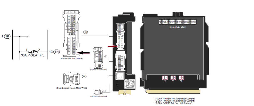

    It wouldn't be a tap. Find the connector 1H. It's on the cab side top of same fuse panel you are showing.
    The 30A fuse is on the side of the fuse panel, not where all the main fuses are.

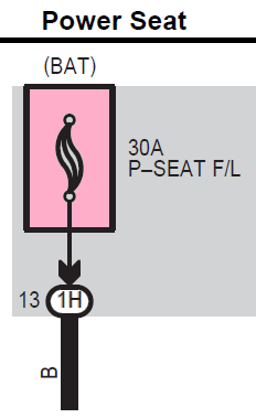

    1H:
    Bottom BLACK wire opposite of the purple thin one

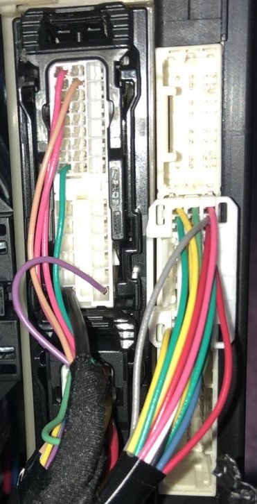

    Looks like I have a green wire there.
    That is the only location i can use?
    really appreciate you taking your time to respond to my questions. Very helpful indeed. 20250517_122503.jpg

    "Seems" is not same as verified...:burp:

    Just confirmed, that space you mentioned is available. One last question..what type of pin do I purchased to add to that harness? Is it a molex? Really appreciate your help..

    That I haven't found out...yet. Just another thing you'll need to confirm. With a DMM, verify continuity from missing wire pin to missing fuse pin.
    P.S. Careful one pin where fuse goes is always hot (battery).

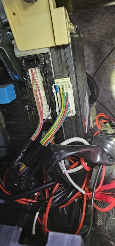

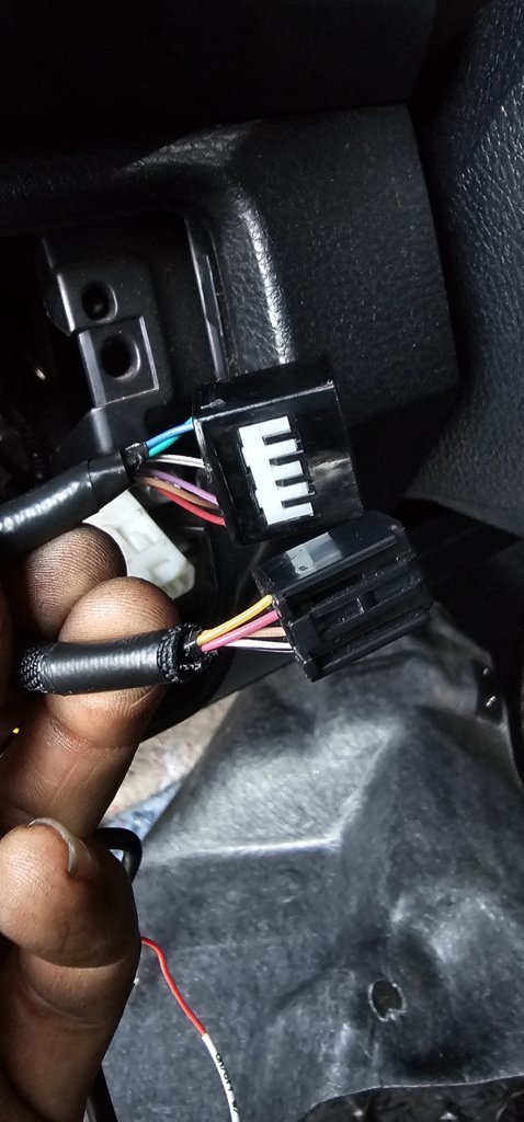

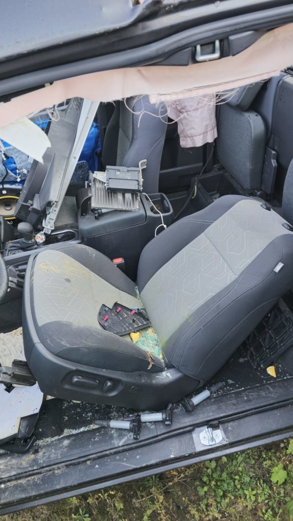

    Had a quick question, do you happen to know what these extra plugs are for? They're just sitting there in my dash..one of the plugs has a switched power source.
    Also a white plug with a single green wire right in the middle of the plug
