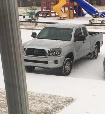

    I have a 2.5 inch leveling kit on front and I believe 1.5 in back. I'm currently running 215/70/r15 on them now, but I was wanting to get me some nice set of mud grapplers to stick on the stock wheels shown in picture. I have a lot of space as you can tell. Was wondering If I put 31/10.50/15 on there would I have any trouble with rubbing? And how much more would it lift my truck up? It's definetly a huge difference in tire size so I'm sure it would lift her up a little more

    I don't think Nitto makes their Mud Grappler in anything less than a 33. But that size should give you another inch of lift

    Do 15" wheels clear the brakes? I thought you had to run 16" or larger on the Tacoma.....

    Most 2wd have the 5lug 15" stock. It's hell trying to find the right rims for truck., that's why I've just decided to get bigger tires rather than wheels.

    @BPauley3 if I remember right the bolt pattern is 5x4.5 witch is the same as older jeeps, a lot of Ford's etc. Finding rims should not be hard. The center bore might be hard to get the right size. I would suggest hub centric rings to get them to center on the hub correctly.
