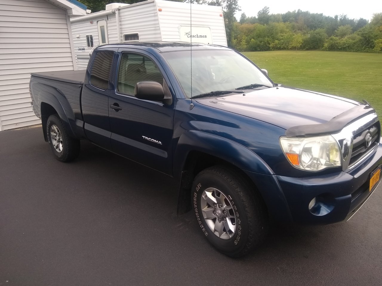

    Truck was sold.

    I am really just looking for a decent platform to start from. I have looked at some 4.0l manuals but most have frame issues from being in northeast. That and a high price and over 200k for miles. No worries i will keep looking around. Thanks for the input.

    Yes. Compared to all the others i looked at this was the the best. I would have liked my engine guys to at least have a look. Anyway i think someone will have a nice vehicle with a new waterpump and engine.
