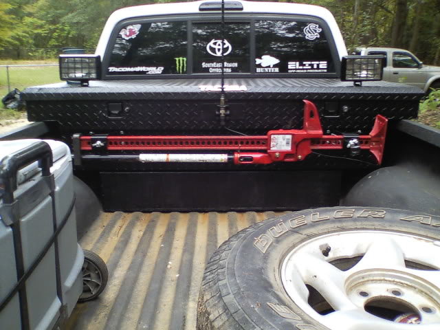

    I'm thinking about installing my Hi-Lift jack on the front wall of the bed just above the floor. Anyone out here do the same? I don't have a clear plan on what type of fasteners to use as getting some bolt or nut up between the cab and bed will, I believe, be difficult. I'm open to any suggestions.

    I did this for a while...

    I appreciate all the options thrown out there, but I am really forced to mount it to the front wall of the bed near the floor, so what I really need to know is how to fasten the mounting brackets to the bed. Please keep in mind I'm trying to figure out how to get up between the bed and the cab with a nut or bolt or some other type of fastener.

    only thing i can think of would be to put the nut between the cab and bed and bold in the bed. as far as getting it there, if you lay under the truck, you might be able to get your hand and arm high enough to hold it with a wrench as a buddy tightens the nut.

    Cool deal, the bolts on it are a bit long and if they are too long to fit between the bed and cab then just get a dremel and cut em down a bit... that's what i did inside my box.

    As far as getting behind the front of the bed at the back of the cab...you could try to find a long open-end wrench.
    Another option would be to weld a metal dowel rod on the end of an open-end wrench and use that to hold the nut while you tighten the bolt from inside the bed. You'd have a dedicated tool to keep in your truck for tightening the mount bolts. :D

    I mounted my C02 tank to the front of the bed and starting the nuts was a pain :mad: but if your mounting at the bottom it shouldn't be too bad. Just mark where you want to mount it and drill the holes. Your not going to be able to get the bolt through the bed from between the cab so i would fab up a bracket of some sort to mount to the bed to make your Hi-Lift easy to remove

    Find a buddy and pull the bed off the truck. It's not that hard. Bolt up your brackets and put the bed back on. Buy your friend some lunch for helping and call it good.
