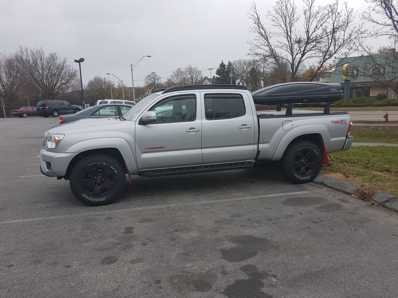

  15. Jan 29, 2017 at 2:57 PM
    HawkShot99
    HawkShot99 Well-Known Member
    Oct 20, 2015
    #167182
    2,211
    Kingston, NY
    13' Silver DCLB TRD Sport - Sold
    265/70-17 fits with no lift.
    I keep considering a small leveling lift on the front for looks, but have not pulled the trigger since it's not needed.
  16. Jan 29, 2017 at 3:06 PM
    #16
    Kelby09
    Kelby09 [OP] Member
    Jan 26, 2017
    #208746
    9
    2014 White Tacoma SR5 4x4
    None
    Looks good but sure is looking like a tight fit with no lift.
  17. Jan 29, 2017 at 3:09 PM
    #17
    Kelby09
    Kelby09 [OP] Member
    Jan 26, 2017
    #208746
    9
    None
    Mine does not have the TRD package I have the SR5. The TRDs sit up a little higher don't they?
  18. Jan 29, 2017 at 3:25 PM
    #18
    HawkShot99
    Oct 20, 2015
    #167182
    2,211
    Kingston, NY
    Plenty of room. Have had no issues rubbing, and I have done nothing to make extra room.
    I must have missed that. Not sure to be honest. It doesnt look taller in parking lots but not sure.
