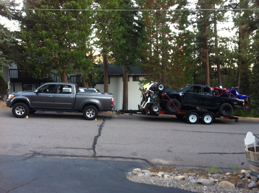

    I use axle straps. One over each LCA and two over the rear axle. Never failed me:
