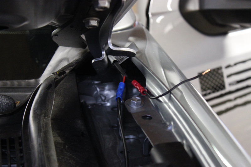

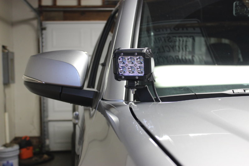

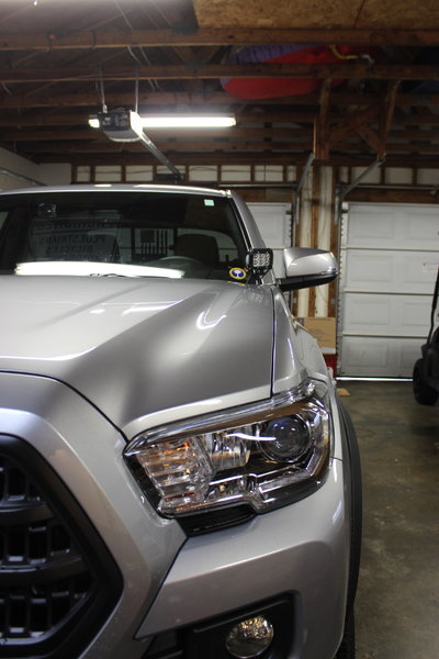

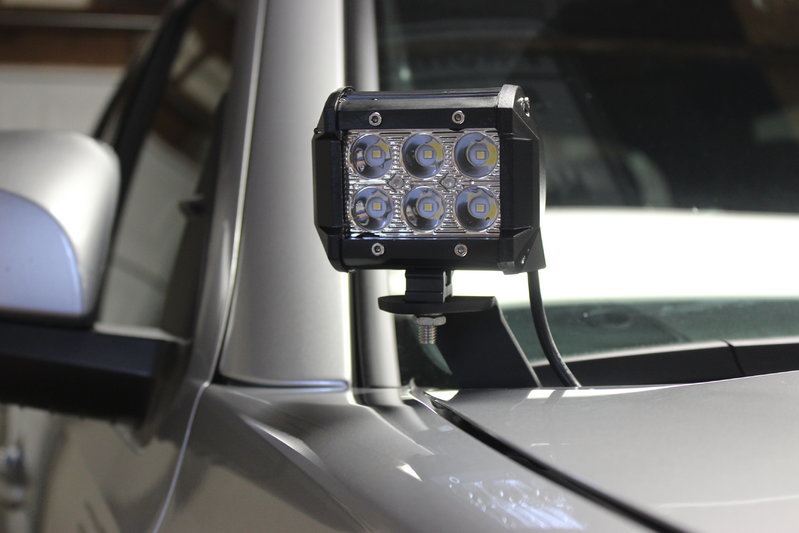

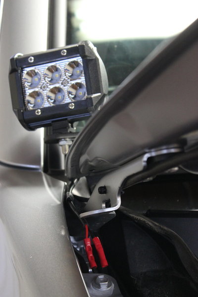

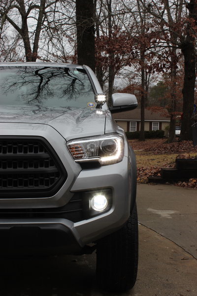

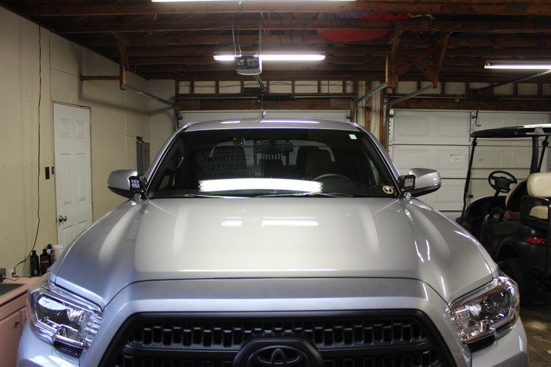

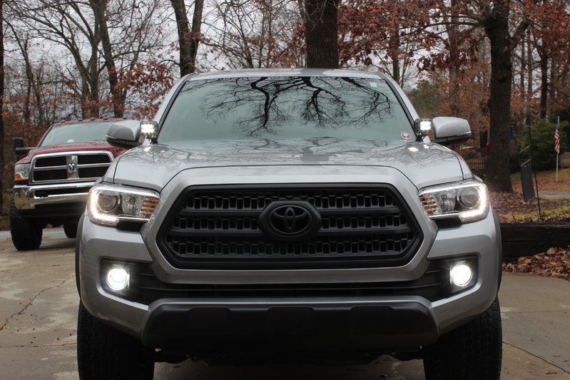

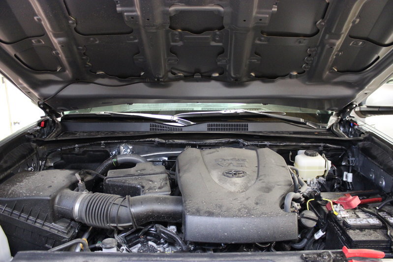

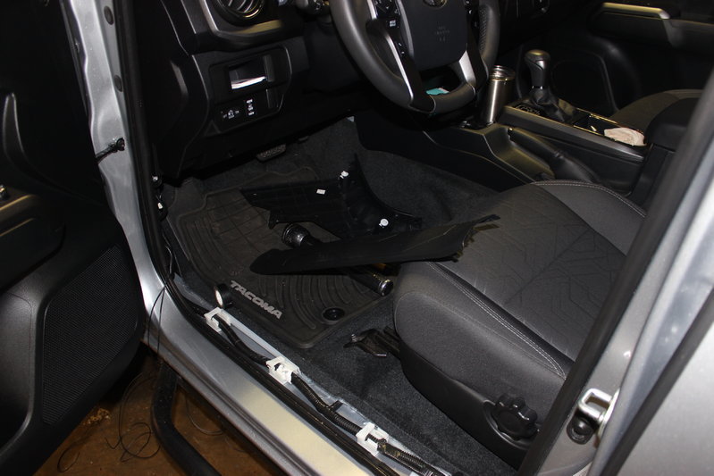

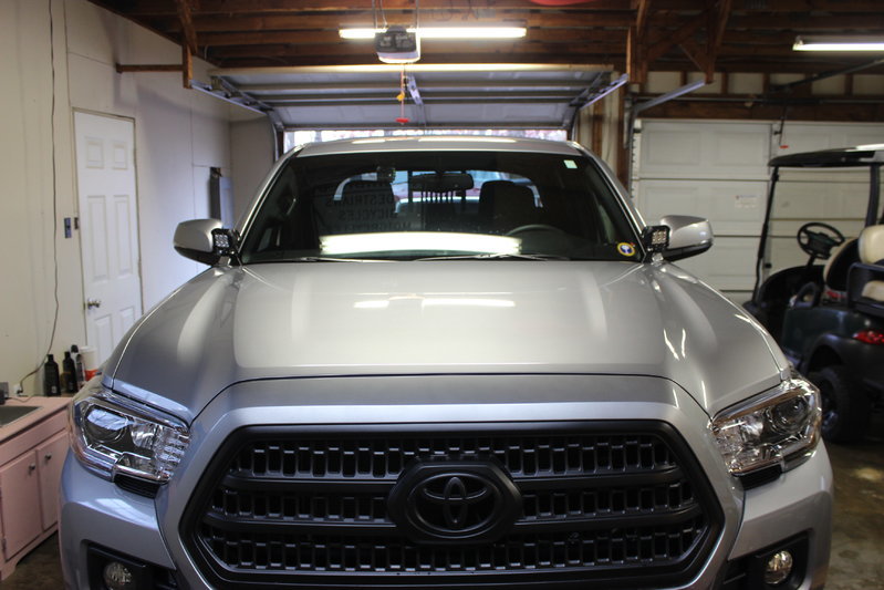

    Got my CBI ditch light brackets in a couple days ago and decided to install my ditch lights. As always, it was aggravating routing the wires and such but it's finally done. These ditch lights are temporary for now...The wife ordered these off ebay for christmas but I wanted the other style so they are in the mail and will be changed out once they arrive:)
    http://www.cbioffroadfab.com/products/3rd-gen-toyota-tacoma/3rd-gen-tacoma-ditch-light-brackets/

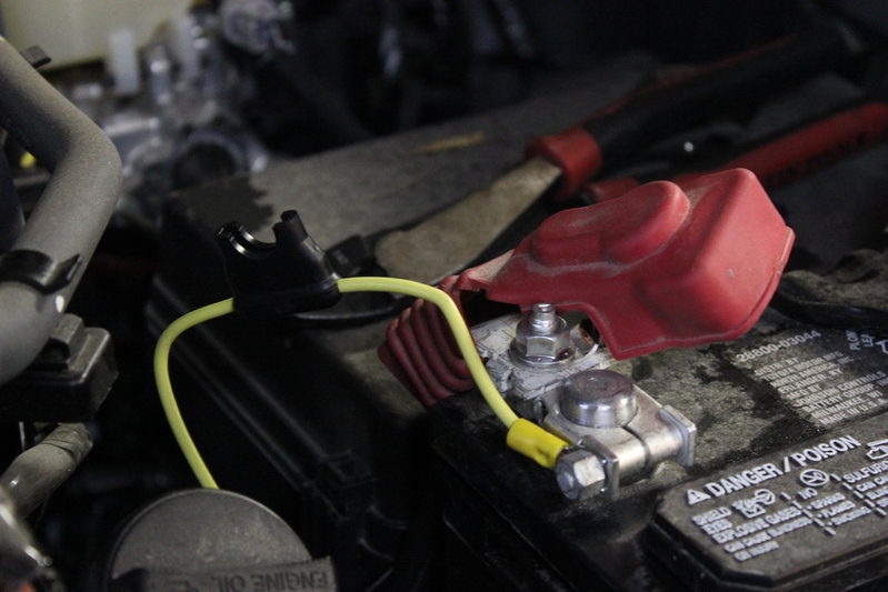

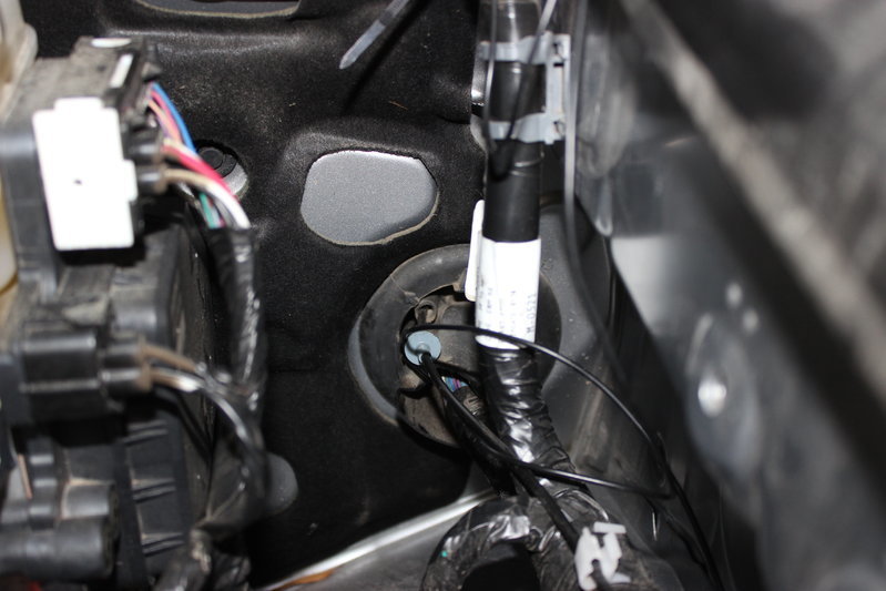

    I ran a constant hot with an inline 5A fuse from the battery through the rubber grommet that the main harness runs through in the firewall. The constant hot runs to the switch and then the load wire comes off of the switch and goes back through the same rubber grommet and to the driver side ditch light. I ran another wire from that driver side light across the top of the firewall to the other ditch light and then zip tied it to the wiring harness. For my grounds on each light, I ran a short ground to the 1st bolt at the back of the fender. My final wire was the switch ground which I ran to the harness ground that is behind the driver side kick plate.
    I wished they made black butt connectors and spade terminals but I could not find any so red and blue it is.
    I installed a temporary rocker switch for now in the blank slot to the left of the steering wheel but I am waiting on my Mictuning switch to come in to give it that factory look.

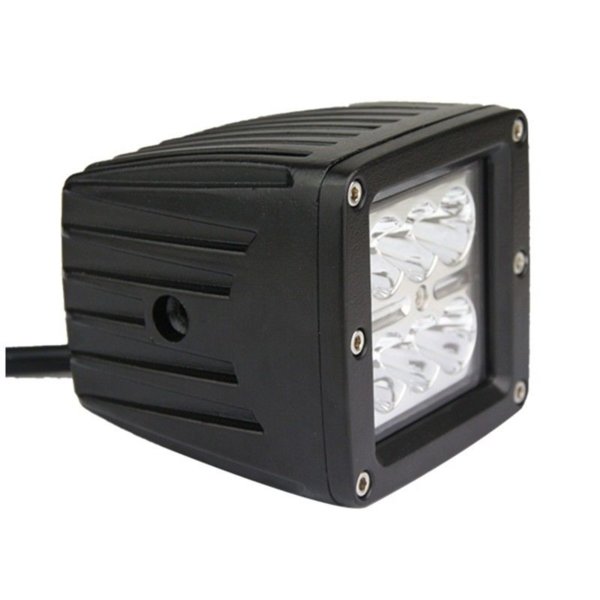

    This is the lights that I have coming in the mail.
