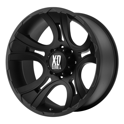

    Looking at a set of XDs, but they dont have the "ideal" backspace and offset for the 285s I want to run. (DuraTracks)
    Anyone running this set up, or very similar? Just wondering what you had to mod to get them to fit. I will have a 2.5-3" lift (5100s@.85 and Eibach coils)
    I'm hoping to avoid the need to chop the cab mount, and rubbing on the UCAs. I don't mind cutting the plastic, ditching the flaps and the ever so common inner fender trim.
    The Tires are just under 33" by a hair.
    Goodyear DuraTrac's
    Size - 285/70/17
    Tread width - 9.1"
    Section width - 11.5"
    Overall diameter - 32.8"
    Revs per mile - 635
    Crank's:
    Size - 17" x 9"
    Bolt Pattern - 6X5.5
    Offset in mm - 0
    Backspacing in inches - 5.00
    Centerbore in mm - 106.25

    are you going to go offroading?
    I have the same size tires and rim with offset and you will need to chop the body mount to avoid rubbing it.
    If you do not offroad and just have a mall cruiser then it wont be that serious. You will from time to time, while turning going over bumps have some rubbing on the body mount. Cut the plastic like crazy, definetly trim inner plastic fender and ditch the flaps.
