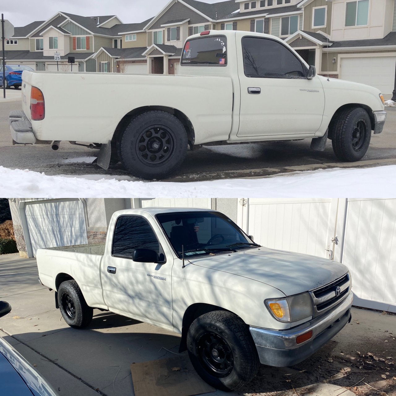

    Looking for a suspension expert to help me out with numbers on QA1 shocks and Spring setup for my single cab 5lugger...
    I want to run fabtech spindles and get the 3” stance. Then I want to add QA1 adjustable shocks w/ springs. If someone wants to help confirm my numbers are correct for the application I pulled some comparisons,
    Front Stock Shock
    14.00” extension 9.00” collapsed
    Fabtech 3” lift shocks
    14.3” extended 9.5” collapsed
    I found QA1 GD507 shocks at
    14.5” extended 9.630” collapsed
    Should I go shorter than the fabtech shocks? And what spring rate would I would need? QA1 has up to 850lb springs

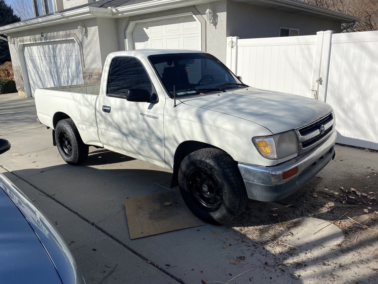

    this is my current setup with 1.5” daystar
