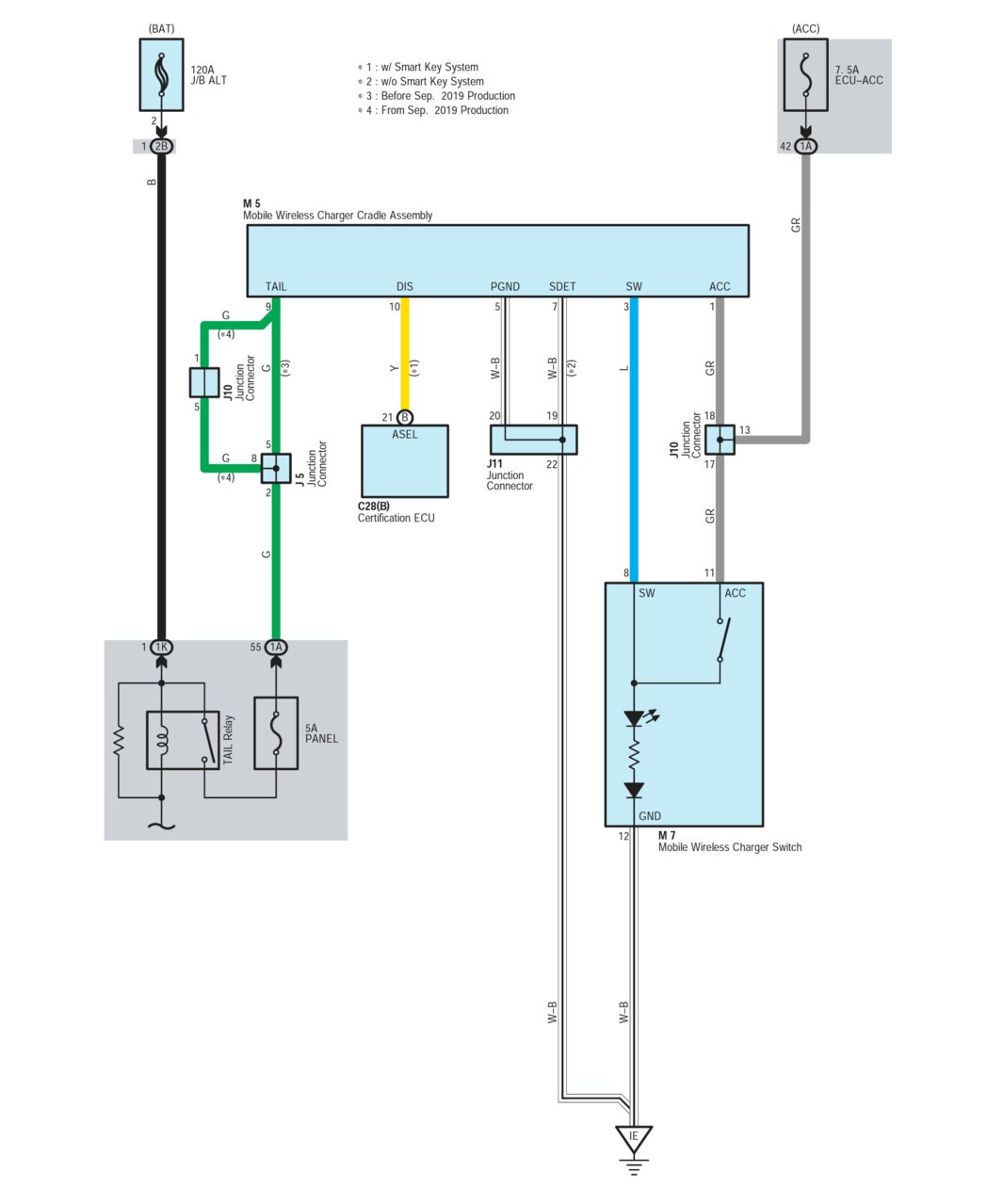

    Thank you for the diagram! I have been searching for days for this type of diagram. My vehicle is actually a 2023 Corolla Cross Hybrid SE, with a Qi charger. I want to disable the Qi charger so I can use the cubby hole space in which the Qi charger is located for storage. My CCH has 5A fuse labeled ECU-ACC which I am tempted to try removing, and see if that controls the Qi charger (and only the Qi charger). Would you know if this is true?
  11. Jan 1, 2024 at 11:39 AM
    549BR
    549BR New Member
    Jan 1, 2024
    #440675
    2
    Well, I can partly answer my own question. Pulling the 5A fuse for ECU-ACC in my 2023 Corolla Cross Hybrid SE did disable the Qi charger ... but it also disabled the Multi-Media Display for back up camera, radio, navigation, etc. I guess my next step will be to try dismantling the center console and just unplug the Qi charger, wherever that plug might be.

    @caribe makaira may have access to the diagram you need. There may be others as well, but I see posts with schematics from them more than others.
