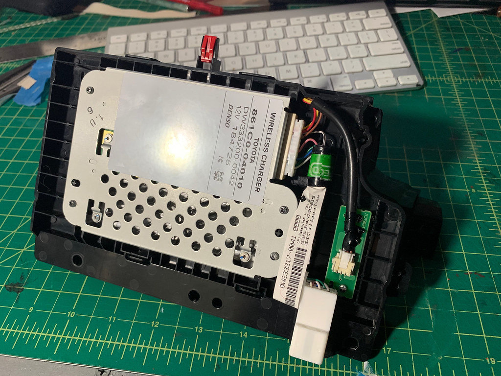

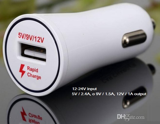

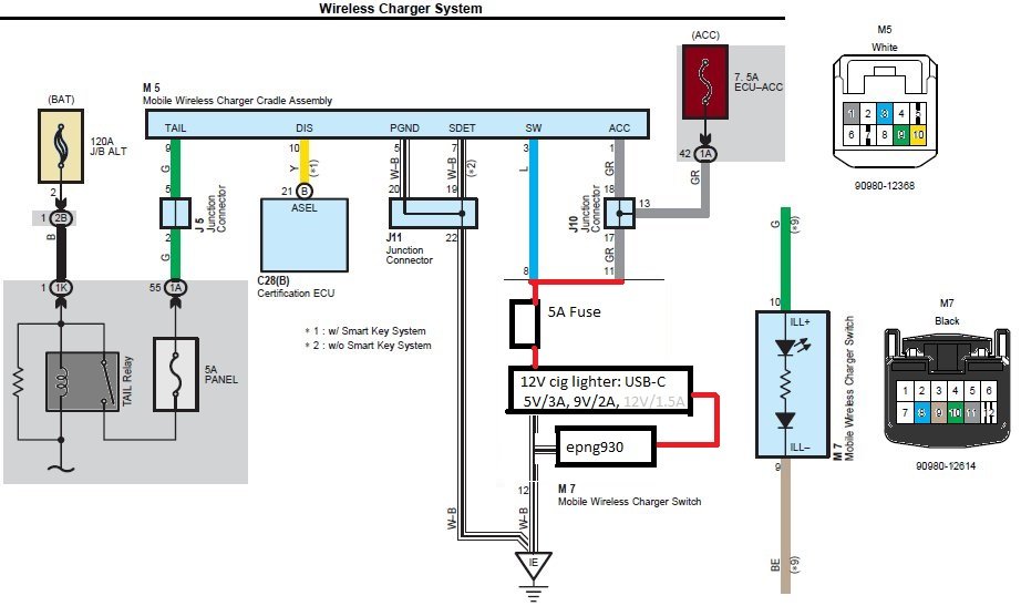

    Use a USB dongle that requires 12vDC, have switch control the input to this added dongle. Then from dongle to charger..

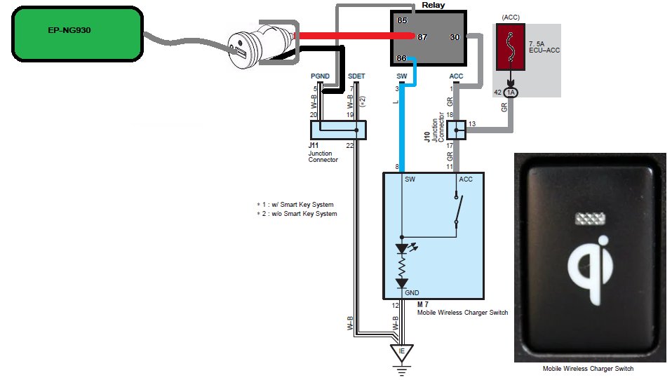

    Didn't see the diagram before I refreshed.

    Running equipment at voltages higher than what it’s built for will drastically reduce its life (think days/weeks as opposed to years) It’ll work reeeeally good,but only for a while if it doesn’t burn out fuses. I think your best bet is to find a 12v vehicle plug for your charger and plug it into the dash,then try to hide the wiring and mount it under the regular Qi port after doing away or disabling the factory one. Other than that maybe a small 12v-9v transformer like what is in the cigarette plug that would come with the wireless charger. Would be small and easy enough to wire but not sure where you’d get one or where to put it.

    Close, but not exactly what Samsung states...

    And the more I think about this, it seems like it would just make more sense to use the guts of something like than and tap into the actual cigarette lighter circuit because that has a 10A fuse I belive. I would still want the switch functaniliy but I never turn the thing off...so :notsure:

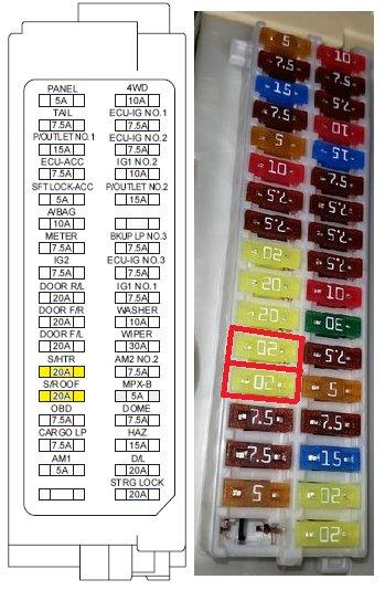

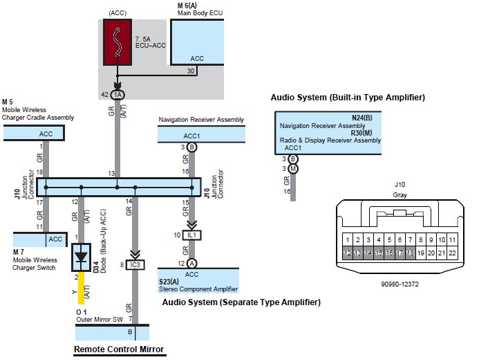

    These are the circuits that share the 7.5A ECU-ACC fuse:
    The only circuit that really pulls any real amps is the Qi charger, the rest are input signals. Using only the Qi switch would also just be "signal" power. If you don't have seat heater or sliding roof those are available to use...

    So it is a 7.5A fuse, don't know why I was thinking 1A. I do have both those options. You've been a great help so far. Gonna do some more thinking.

    Sliding Roof (S/ROOF) is always HOT/Battery - Seat Heater is IGN/ACC (S/HTR)

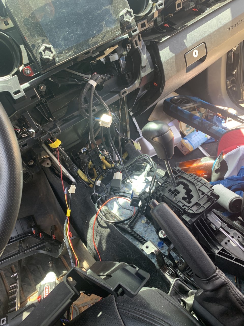

    Has anyone does removed the Qi charger and have pics of the wiring before it actually removed. Or seen post where this has been documented. I have seen this pic on other threads but was wondering if there some actual photo documentation other than this.
    Credit:johnny6.

    damn, i just put my whole dash back in today! i wish i had taken more pics for you guys :(
    i’m planning to make a new tray and add a generic wireless pad with an add a fuse later... right now i just put all the stock stuff back so i could have a truck again.
    (fyi this was all to wire my heated seats and relocate my usb data to the glove box)

    I like the idea of knob upgrades for the entune radio dash but the rest of pic is making me uneasy, lol. I know it probably seems worse than it actually is as I have taken a few photos like that before, but that doesn't inspire any will power to go ripping out my dash.

    Sorry been dead lately, work work work:p Why not just go this route as the wireless charger has never caused me problems despite being plugged in forever. Rather not have to deal with a switch for it and I feel as if the circuitry in the EPNG930 has some fail-safe in itself as well.
