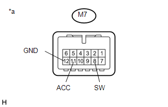

    Cut the wiring harness that connects into the factory charger.
    Using this image pin 11 is power and 12 is ground.
    Solder these two wires to the input side of the voltage step down. Using a multimeter turn the step downs adjustment screw until 5V are being read on the output. A drop of super glue can be used to lock this screw in place.
    With the step down now converting 12V to 5V, cut the magsafe wire and solder the red wire to the + and the black wire to the -. At the same time, solder the same wires from the fan to the respective terminals.
    Everything should work now. Place the phone on the charger to verify its charging and press the QI button to verify that turns the charger on and off.

    No need to cut. Leave OEM harness intact.(M5) Crimp terminals on connector to original charger, use factory switch to turn on/off added Lollypop charger.

    Yea I don't have a pin removal tool or else I would have just swapped the pins. Splice terminals could also have been used, but personally I don't like using them.

    You would have to de-pin or splice. Crimp terminal to added PCB wires, insert into mating connector, use OEM switch for ON/Off.
