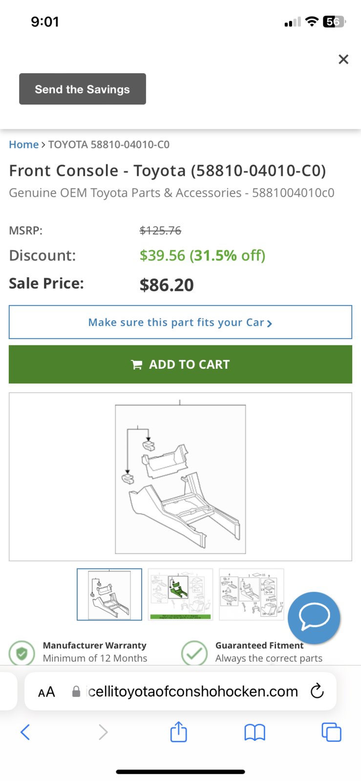

    Th Qi charger is pointless for me and I’m looking to delete it. Who has done it?
    I found the attached part diagram on another thread, but when I searched the part number online the diagram shows something different.

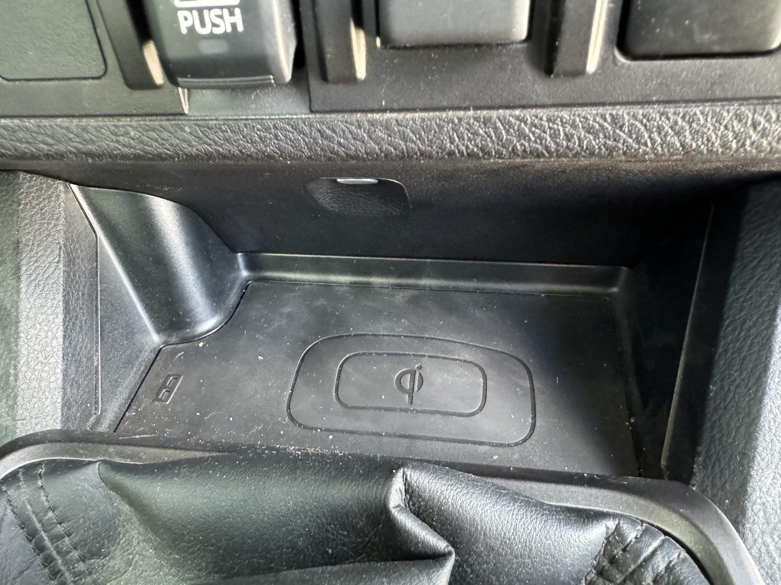

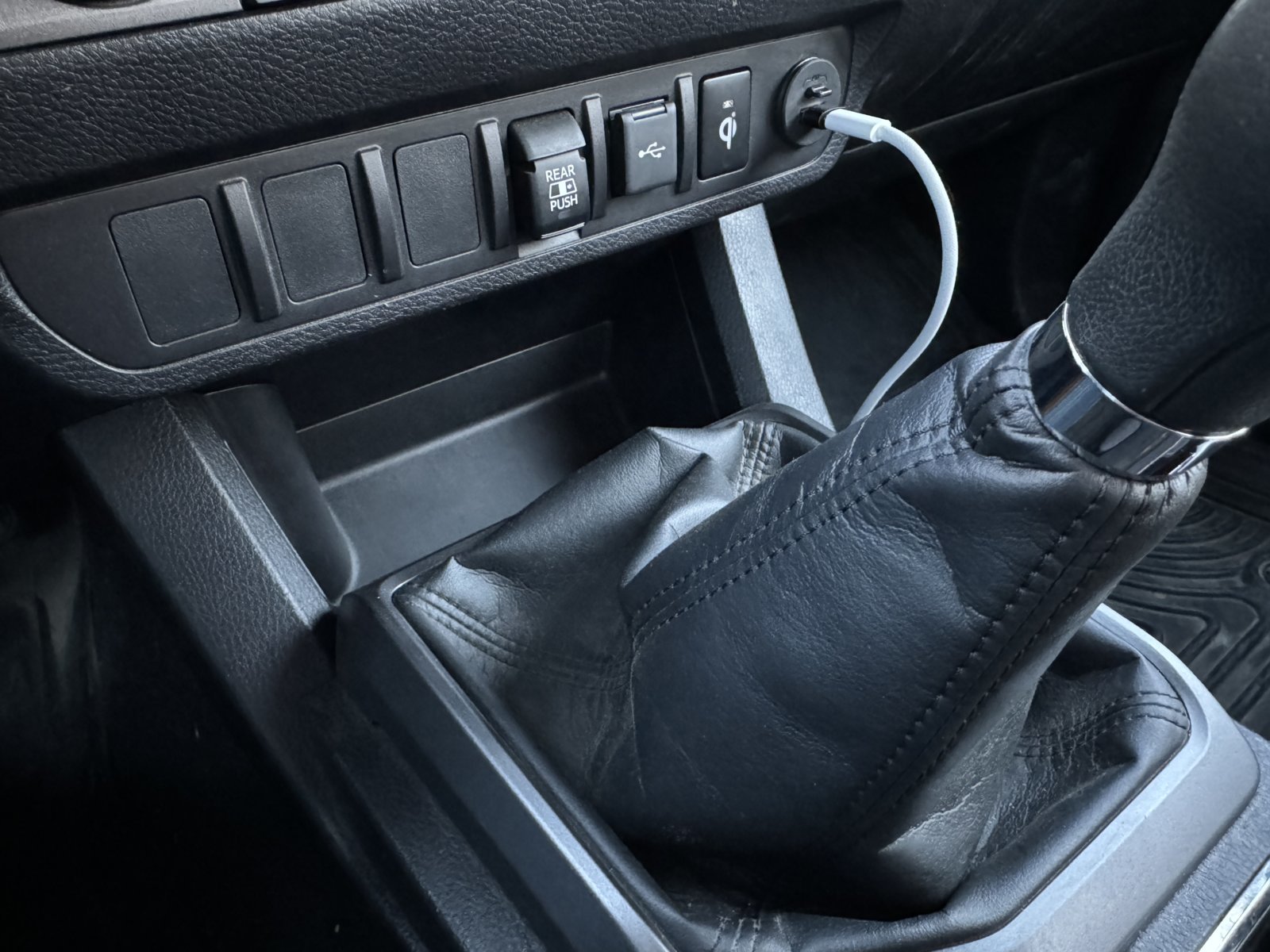

    I swapped.
    When you buy the front console half (which is what you have pictured), it comes with the tray and the front console half. I bought one from an SR automatic because they are way more common than SR manuals. You only need the tray, you don't need the console half unless yours is beat up and you want to replace. Since I bought the auto version, I couldn't use the console half anyways so I chunked it in the trash immediately once I removed the tray from it.
    The non-charger tray is both better and worse than the charger version. My charger one was bubbled really badly in the middle and so nothing would sit nicely there. The non-charger version is deeper but angled so it provides more secure storage but probably less overall usable storage. I like that it's more like a bin instead of a flat spot, so I can empty my pockets for road trips and throw it all down in there. I have 0 regrets with my swap.
    I swapped the tray and then later removed the switch and zip tied away the plug to the harness so that it wouldn't rattle around.

    Do you have a part number by chance?

    I bought the one in the first post. 58810-04010-C0

    Thanks guys. That looks like a worthwhile swap for those of us not using the charger. I looked up the part number and it appears that includes the entire console and the cubby I have an MT so I guess I can swap in the cubby and toss the new console ? Or should I try to find a VIN for a MT without Qi (pre-2018??))
    would be great to just buy the cubby!

    Don’t worry about finding the 16-17 MT version, I have a 6MT and I bought the 4 cyl AT version. Yes, just throw out the front console half you receive or donate to a friend. Or sell if you really think someone will buy it. The cubby bolts in the same no matter what front console you have.

    Not hard at all. Remove shift knob and pull up console finisher, empty console and remove two bolts at bottom under the felt pad, undo the screws on the front console half and unplug the charger, then remove the front console half, remove the charger and then swap the tray in its place and reinstall. Like 10-15 minutes for me since I’ve been in there a lot, for someone new to working on the console maybe 25-30 min.
