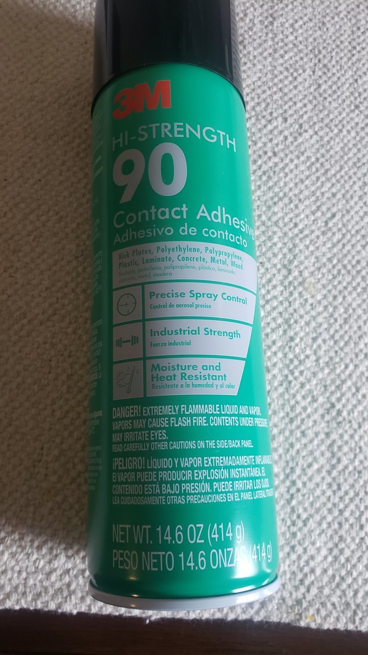

    I know this is an old tread. But you can order 861C4-04010. It’s 42 bucks from Toyota. It replaces the top bubbling pad. Be careful on eBay. There being sold for 100 bucks. Crazy but Toyota has it for 42. Keep in mind this is the top replacement rubber NOT the control unit. If yours works but the bubble is an issue. This fix is for you. Don’t glue it as another guy did.

    I used 3M hi strength adhesive that someone here tried to glue the rubber with charger. The qi charger looked new when I was done, but the bubble returned after a month.
    I'm so pissed I wasted money on glue and time and the bubble is back.
    Don't use the glue of the picture, not a solution.

    40 dollars gets you a new pad. Oem. The time it takes you to glue it. You can get it new.
