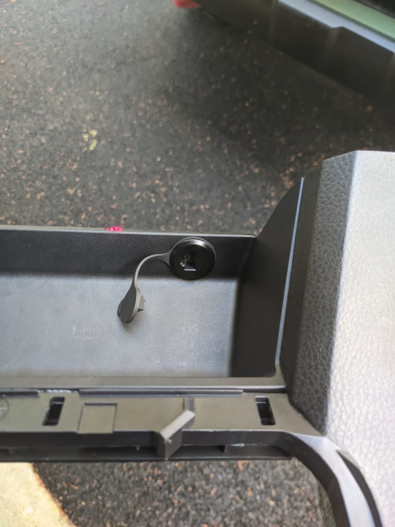

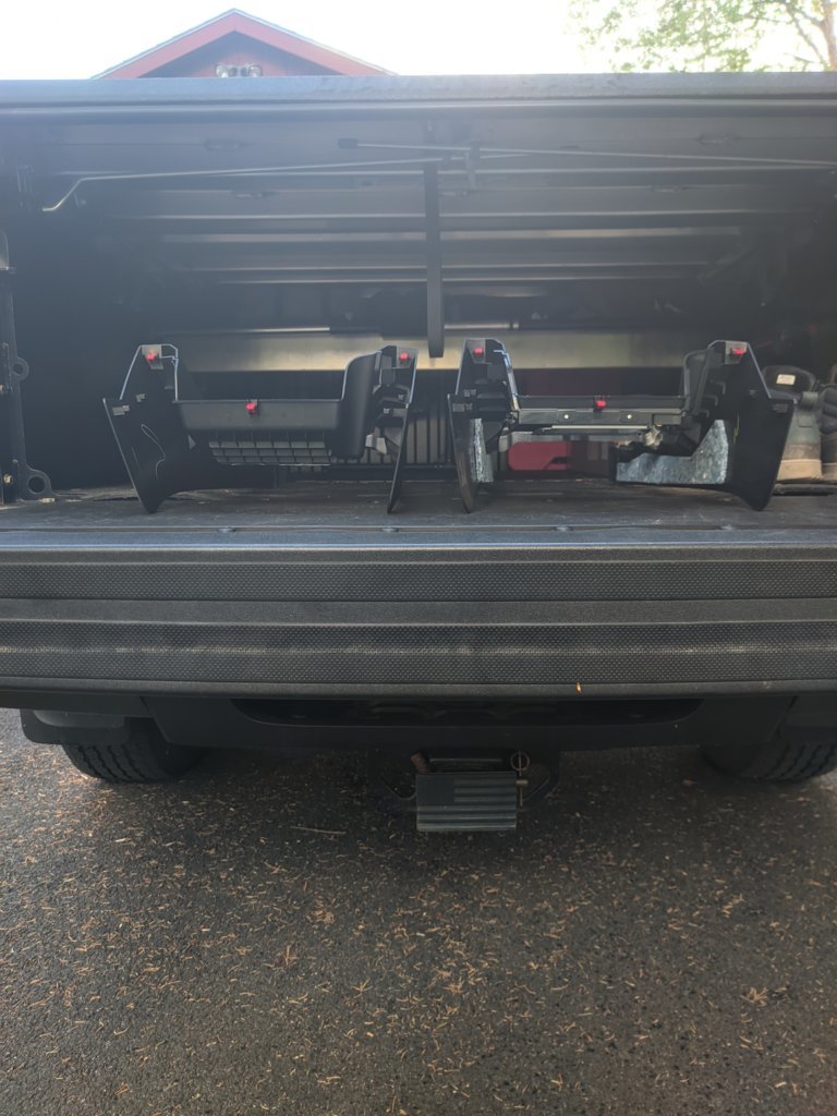

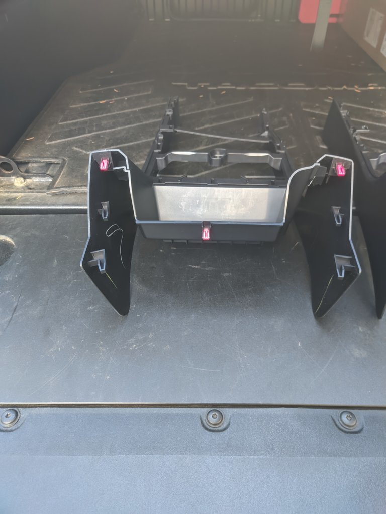

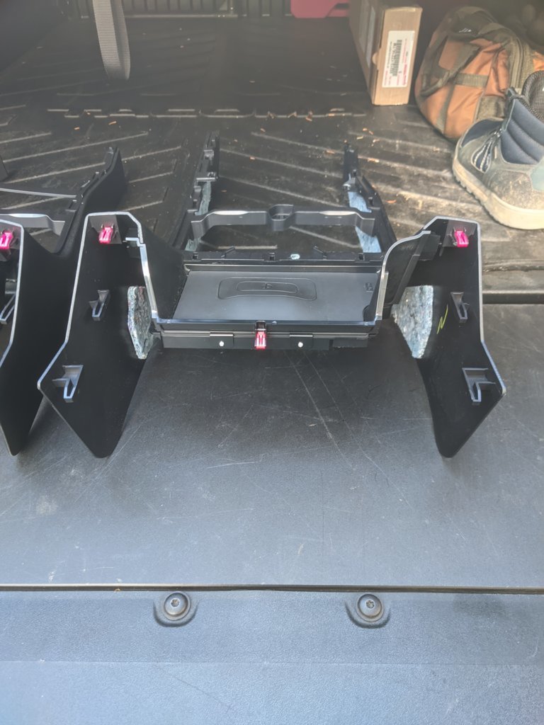

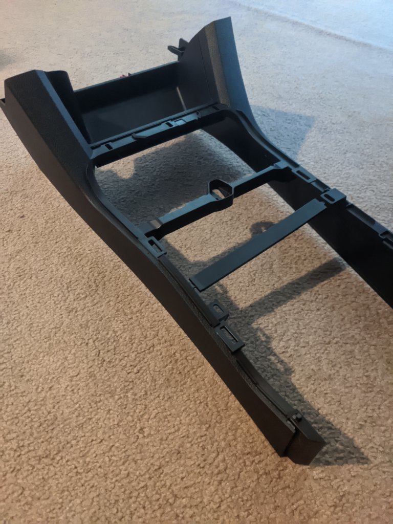

  18. May 3, 2025 at 5:50 PM
    #138
    shiftd
    shiftd Well-Known Member
    Jul 9, 2020
    #333973
    130
    Pennsylvania, USA
    2020 Tacoma TRD Pro
    Following up on the storage cubby. The SR5 cubby fits right in. Here are a few photos. I could only find it for sale paired with the transmission tunnel trim. If you can find the cubby alone that will work too. It's attached with five screws to the larger trim. In fact I reinstalled the trim that came with my taco because it has some insulation fabric attached that I figured I'd keep.
    My plan was to use the area for a radio install so I also fastened some magnets the underside of the cubby and installed a RJ45 pass thru in the rear. I'll post some of the radio install in the ham/cb thread
