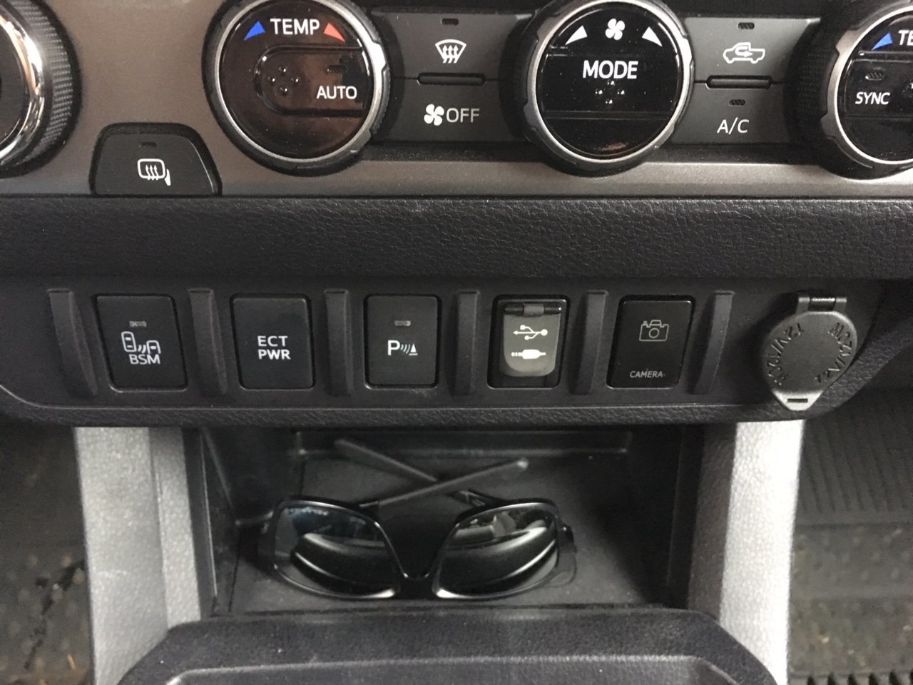

    Here's how I "fixed" mine! Gave the switch away and put in a front camera switch.
