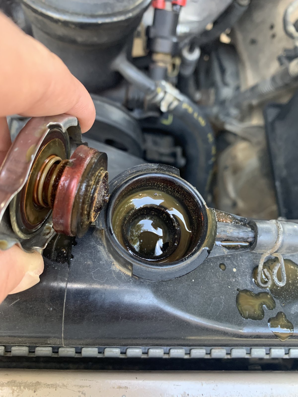

    Clock Volt meter/LSPV Delete/Hyundai 16’s/FP gauge/after 9months of wrenching ZERO oil leaks
    On 96 2.4L
    Which is “suction” hose?
    Upr or lwr
    Cheers

    Anyone wants to recommend the best chemical cooling flush product?
  4. Jul 4, 2024 at 1:15 PM
    02hilux
    02hilux What do you mean there’s no road, I’m here
    Sep 14, 2016
    #197244
    6,314
    Planet: EARTH
    None
    MadNachos and Black97v6MT like this.
  5. Jul 4, 2024 at 1:46 PM
    ControlCar
    ControlCar [OP] My Moto: Help & Learn…period.
    Jul 22, 2023
    #429578
    3,491
    Steven
    Sugar Land TX
    1996 Taco 2.4L 2wd Automatic
    Huh
    just distilled water then?
    may I ask why no flush cleaner?

    What would you be trying to flush out with a chemical flush that distilled water couldn’t flush?
    ChrisFix has a good rad flush video on YT.

    Nasty brown coolant
    Just thinking flush cleaner with D. water would do better job
    if flush cleaner not needed NP
    finding vid….thanks

    If you have an old radiator......flushing the engine with chems may clog it and/or heat core...
    or even cause the plastic to radiator to leak...
    So i'd be careful here....maybe distilled water....
    ControlCar[OP] likes this.

    I always flush with plain water from the hose. Run a day or two and do it again. Repeat till it drains clear.
    Then drain and refill with a premix. There won't be enough of the other water left to matter, and the premix means you don't have to futz with distilled.

    Is it even a bit pinkish?
    There is a nice sale on yota pink currently
    About 15$ a gallon

    Last time I flushed an old radiator.....
    I just filled it up once a day with the garden hose.
    Drove it around.....and did it again next day.
    It took 6 or 7 cycles to get the pink stuff to run clear....

    Ok guys
    I wasn’t going to post a ‘My taco overheating thread’……..without searching
    I think I got plan
    Just need experts opinions
    now is HOT here in tx
    Had 2 1hr+ trips in last week
    1st I was on 80mph tollway
    I was dogging her, 75-85
    Temp(idiot gauge) started moving up
    2nd another trip….kept under 75
    Not as bad, but gauge definitely rose(over horizontal, not in red/pegged)
    1st time hit heater
    Temp dropped like a stone
    2nd time turned off AC and slowed down
    so I have a hot at hwy speed issue
  13. Jul 4, 2024 at 4:09 PM

    If it was mine....I'd block off the heat core.
    flush it with something from auto store.
    then replace the radiator.....
    .....head gasket, valves, tranny, ....no body likes heat....
    heat greatly shortens their life...
    You know these single core crimp top radiators suck.....
    I think of them as the starter cartridge you get with a new laser printer...

    Start simple.
    Make sure the condenser face is clean
    Make sure the space between the condenser and radiator is clean
    Make sure the radiator face is clean

    How old is that radiator? Are the fins all filled with gunk and / or has it been painted a bunch?

    Now I pretty confident(from searching)
    It’s the Rad
    -pulled prior owners records
    Last rad installed 2020
    -I RR’d T-cover gaskets while back
    So new h20 pump/t stat/new coolant
    (Not flush)
    -I soaked the 5yr old rad in vinegar overnight during that job
    -ECT (head) RR’d
    -great compression test results (when I got truck
    -lower rad hose is new(not collapsing)
    -RM injectors RR’d so not running lean
    -doesn’t run hot at idle(not fan clutch)
    And shroud is present
    now I didn’t know about 2 things last major wrench job
    1-that 12 o’clock setting of that wiggle thing on T-stat
    2-that block coolant drain bolt on 2RZ
    (Pass side….correct?)
    everything I read today says radiator
    Bought rad(last freaking one on RA and rad cap) today
    also plan on TOTALLY flushing coolant system
    Heater core/block…..which I didn’t do the first time bc I was newbie here!
    ANY advice/tips appreciated
    Cheers

    Long shot would be water pump going out...
    a non oem one might deteriorate quickly in dirty hot old coolant...
    the non oem chassis parts damn sure do....
    Same thing with the thermostat.....its tempting to get a $10 one online...
    .....dont do it.....pony up $35 for the real one......way too important...

    pretty sure in 2020(I got in 2023)
    Lite front end impact
    Rad replaced
    I got a laser temp gun
    Might try to find a cold/blocked on rad but doubtful if I have access
    Outside of rad looked fine when cleaned
    must state
    ZERO overheat symptoms throughout entire 9month wrenching jobs
    But
    No long trips bc of no insurance (only test drives)
    Now street legal…..driving longer/harder
    Issue popping up
    no Obd codes BTW
