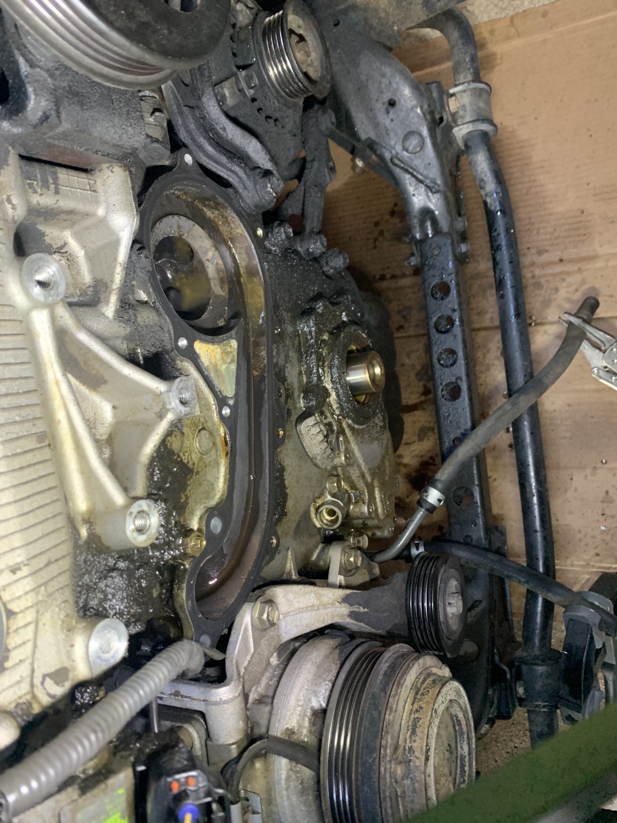

    Somethings not right - I can run AC in high temps with my rad made for a 2.4 on my 3.4 on the highway no issues. No issues with compression test? That coolant looks thrashed if it’s only 4 years old.

    Well, kinda worse (as far as coolant condition)
    this was done…..3 months ago

    Everything basically replaced but the 4yr old rad
    And
    I didn’t flush entire cooling system
    2000 miles since tht job done^^
    so coolant “refill “ only 3 months ago
    leading to summarize that cooling system needs complete flush(s)

    Yeah I just did 200+ miles in 105-110* heat today at highway speeds with my original 16 year old radiator and AC on no problem. Back this spring when my coolant bypass pipe broke and let out half my coolant, the other half I drained looked perfect and a good majority of it was original - just topped off when I was losing it through the bypass pipe weep.
    Your coolant looks dirty and it could be from oil or it could be something else. I know regional environmental differences can play a part in that possibly, but 4 year old coolant should look pretty close to new based on what I’m used to seeing.

    You know when you get a vehicle... what coolant crazies have gone on in the past?
    When you get a toyota with green coolant I would always closely inspect.
    If they mixed the two coolants together.....it could of made a mess.
    And if they did not use the right coolant....it will attack the fipg and the metal gaskets.
    If you flush with any of that damage......you could spring a leak.
    I would consider coolant much more important than oil choice.....it actually governs the life of the engine more.
    I dont like the red coolant......but if you've gone that path, change it way more often than 7 yrs.....
    And if you go the green......there's only two that's safe for toyota's.......the prestone max and the peak 10x

    With updated silicone / metal gaskets in the intake, water pump, and thermostat housing, I can't think of many places on a 5vz that coolant and rtv / fipg touch besides the bypass pipe, but maybe there's some on a 2/3rz. Mixing incorrect combinations of coolants can reportedly lead to clogs, and that would definitely shorten the lifespan of an engine if it's causing it to overheat.

    Honestly I would just go with a flush and see what happens.
    I've never had any issues with any of the radiator flush stuff out there, btw.
    Just follow their instructions and see what happens.

    Getting back to normal round here
    Big issue is my L elbow
    Appears I way over worked it(like Tennis Elbow)
    Getting better but still hurts
    Flush update though:
    After 5 times of water flush (only draining rad after 15m of idle time)
    Coolant went from rust brown to clear
    Over a period of 2 days of draining/refilling
    next step is to drain block(that bolt under distributor) AND flush heater core
    I tried that block bolt today but my arm prevented me from getting drain plug bolt (14mm) off
    keep yall posted
