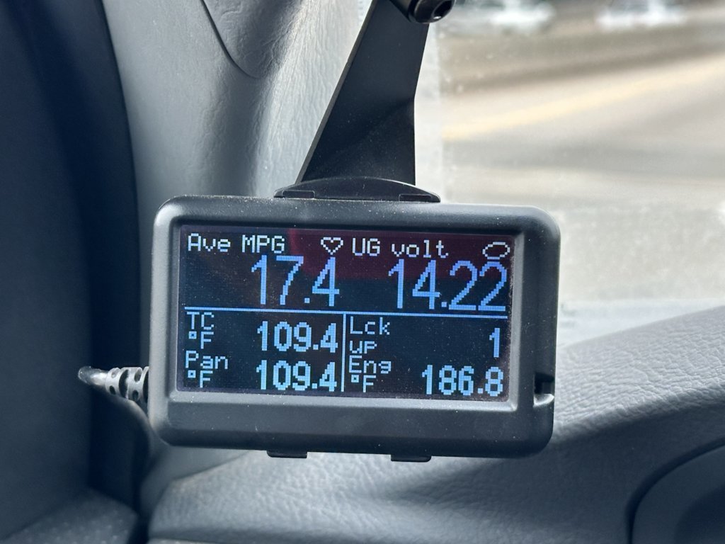

    I can’t remember offhand the exact temp. I have an UltraGauge with an audible Beep alarm set for when the torque converter gets hotter than 215 and when the pan temps get above 200 and I don’t remember them going off, so below that.
    example of how I have one screen set up to monitor:

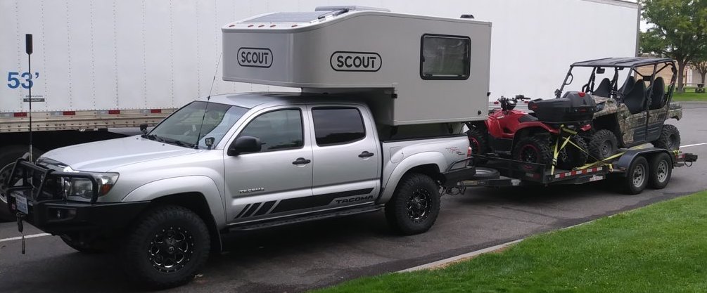

    The best thing I've done for performance while hauling the camper + a trailer is a re-gear. I'm also running a V6 4.0 2nd gen. I upgraded to E loads (which you should do if you haven't already) that were 265/75r16 (so 1 inch taller than OEM) and am running 4.56 gears (3.73 stock). Drive/5th gear was completely useless to me in the past, even with my AT Habitat. I ALWAYS ran in 4th unless I was on perfectly flat ground or downhill. Anytime the torque converter started unlocking and locking I'd shift down, sometimes to 3rd when climbing. With the regear, I can use all 5 gears again. I just throw it in drive unless it's a SERIOUS climb. Fully loaded, I couldn't accelerate up to the speed limit on 18 towards the Tiger Summit, but now I've never hit a highway mountain pass I couldn't accelerate well past the speed limit (not that I ever do that anymore, gas mileage is atrocious).
