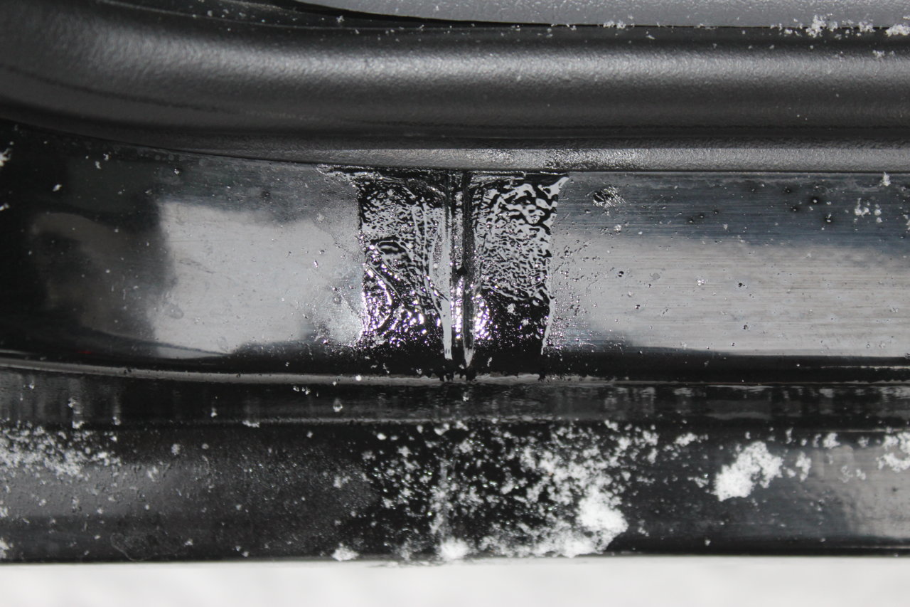

  15. Dec 31, 2019 at 2:51 PM
    #75
    GQ7227
    GQ7227 mw survivor
    Dec 6, 2018
    #275019
    29,298
    J A Y
    what do you think about FF right here in this spot, how durable is it against rain? this other product i was trying that i thought might stick better just washed right on off after 2 inches of rain last week drained through the door channel or wherever the heck it goes IDK
    i heavily applied this gel, even inside the door panel through the drain holes
    i had a small rust spot show up in one of these soft spots late last year and just want to protect this area more, other than washing the roadspray off of my truck, which i just ordered an interesting product from TX that i am anxious to try out to wash it cleaner, will see how that stuff goes!
  16. Dec 31, 2019 at 3:40 PM
    #76
    ClevSix
    ClevSix [OP] Well-Known Member
    Jun 29, 2015
    #158382
    1,392
    John
    IL/IA
    01 DCSB SR5 TRD, 13 T4r SR5
    Suspension, 33s, some armor... Rust, Gray wire and 2Low, and more. T4r is stock.
    In my experience FF lasts similar to a good wax job. A bit of rain or a light wash doesn't effect it much but will take it off eventually.
    GQ7227[QUOTED] likes this.
