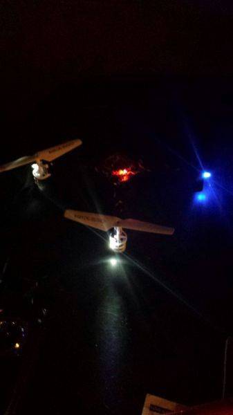

    after about 15 mins of flight time I decided to mod my little guy with some LEDs.
    White in the front and red/blue/green in the rear.
    How important is it to have weight distributed evenly on these? For some reason I only added 3 lights instead of 4 so now one propeller is without light. It was flying a little "off" so I didnt know.

    the controller in the quad wants to keep it level. you'll notice that if you hold it in your hand with the throttle up, and tilt it far enough, the blades on the high side will actually stop spinning, in and effort to level it out. something as small as an LED shouldn't really affect it, but if you're drifting when you try to hover, just adjust the trims acordingly.

    Thanks, Colin. Thats what I had been thinking. And now that I think about it I may have not had it completely level when I pluged the battery in.
