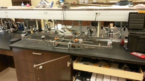

  16. Feb 16, 2014 at 7:01 PM
    #616
    trdNick
    trdNick Odie
    Dec 27, 2011
    #69480
    2,211
    Texas
    2020 Ram 1500 4x4 5.7 Hemi BigHorn
    Here is the multirotor my team and I have been working on for the last couple of months.
    8- turnigy 5000kv motors
    85A ESCs
    13in props
    Not quite sure of the exact battery specs at the moment
    KK 2.1 flightboard
    We are looking for around 25lbs of payload after deducting the frame and and drive train. We have a xompetition March 28 so hopefully we can have it tuned by then.

  17. Feb 16, 2014 at 7:05 PM
    #617
    Btnewman
    Btnewman [OP] Benjamin Newman
    Apr 15, 2011
    #54950
    2,497
    Benjamin
    Grand Junction co
    Uh. It's beat to he//. But it's only 1 owner.
    Custom body work/damage ARB rear locker Bumpers Shocks Other parts Tires and Rims Air tank fully plumbed into truck "Golf ball mod"
    Thats a very interesting layout
  18. Feb 16, 2014 at 7:07 PM
    #618
    trdNick
    trdNick Odie
    Dec 27, 2011
    #69480
    2,211
    Texas
    pretty much an H8
    We have to pass through a 28 inch hoop for size restrictions, so it will pass through the hoop lengthwise, having a max width with props at 27 inches
  19. Feb 16, 2014 at 7:11 PM
    #619
    Btnewman
    Apr 15, 2011
    #54950
    2,497
    Benjamin
    Grand Junction co
    Sneaky sneaky... do they set limits on what controller you can use?
  20. Feb 16, 2014 at 7:12 PM
    #620
    trdNick
    trdNick Odie
    Dec 27, 2011
    #69480
    2,211
    Texas
    Nope, but we chose the KK2.1 due to the fact that it is pre-programmed for our layout
