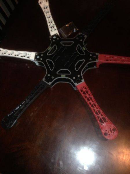

    I am just now building my own hexa lol, I haven't stepped in to the FPV thing yet so I am curious as well. Also I got some goodies yesterday:

    Very nice! I have the same hexacopter, but from Hobbyking. I see you got the Naza Lite, that's what I wanted to go with originally. I went with a KK2.1 instead, but now I want to upgrade.
    I'm also thinking about building a smaller 250 frame. I have a Naze Acro on its way. So I'm debating using it in a new frame or switching out the KK from my hex.
