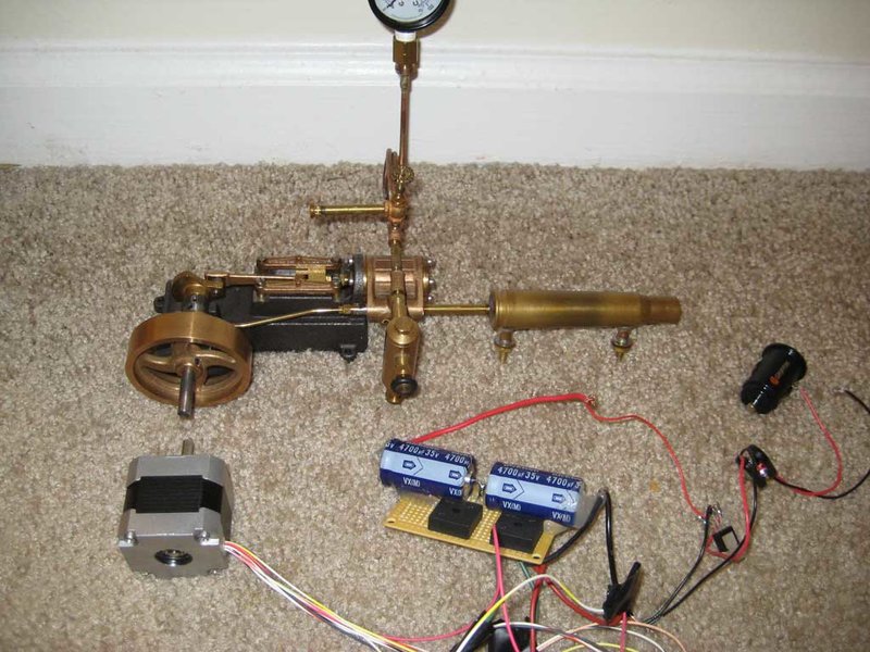

    This is the steam power plant design i'm trying to make work. I need to figure out my best efficiency of pulleys between the engine and the generator. So far ive turned the generator with a drill and charged an old LG- scoop phone. I dunno if it will handle the iPhone draw or not. I need to do more testing. Hopefully this damn thing will work!

    Is that generator based off of using a stepper motor?

    Affirmative. These steppers are interesting. The way I have it wired up there, I can turn it quite slowly and get high voltage. I was able to read 30V by cranking it as fast as I could with my hand. The problem is the amperage. I was able to get it to charge a phone at about 300mA when turning it with a drill, but I dont know at what RPM that was. The ideal speed of that engine is like 450rpm, so I need to figure out if the motor is actually proportional.

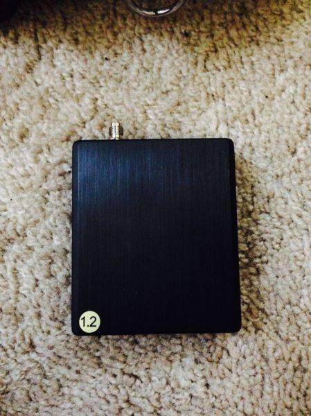

    I think I have just about everything you need minus the GP3 cable. The video transmitter is very high power (1.5watts) and may be a bit overkill for what you're doing.
    I have a smaller 1.0watt video Tx I can sell you that includes the GP3 cable if you're interested... :)
    ebay link here for the case: http://www.ebay.com/itm/151140875931?ssPageName=STRK:MESELX:IT&_trksid=p3984.m1555.l2649

    am i correct in assuming that the difference of 0.5w will only change the transmittable distance, not the feed lag or quality?

    exactly... higher power in theory will give you greater range. My Trasmitters are 1.3ghz (lower freq also travels better through "vegetation"
    Let me throw something together for you and i'll PM pics, etc. so you can see what you're getting into... lol

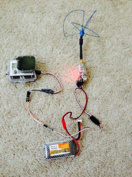

    Aircraft side

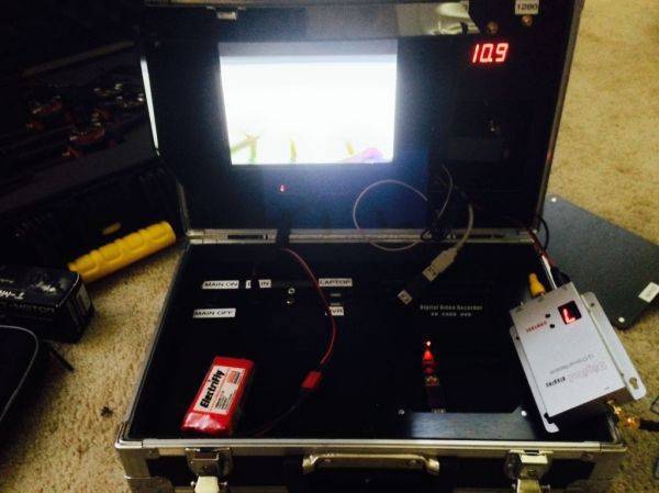

    GCS
    With this receiver instead of the white one pictured above (this one is better quality, I just need a female-female RCA adapter t plug it in to the monitor which it didn't have for this pic).
